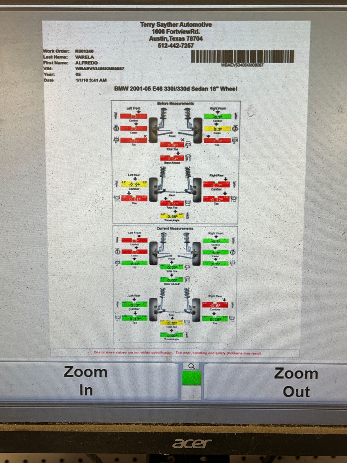

    I got an alignment last week. The shop reported "tie rods frozen, unable to break loose." I agreed to replace the tie rods on both sides, inner and outer.
    After the alignment was done, I noticed some values were out of spec. They said that's the best they could do and some other parts would need to be replaced to have everything green. But they didn't specify which parts. Here's the before and after screenshot. The car drives fine BTW.
    What are your thoughts on this?

    fredo - i assume both rear camber adjustment bolts are moving freely? if so... i would look at your RR lower camber arm to see if it's bent or not. those are pretty flimsy, and designed to be 'expendable' in the event of an impact.
    also, how old are your RTABs?
    for the front, the FCAB impacts caster but the top mount would affect camber and caster angle. how old are your front strut mounts?
