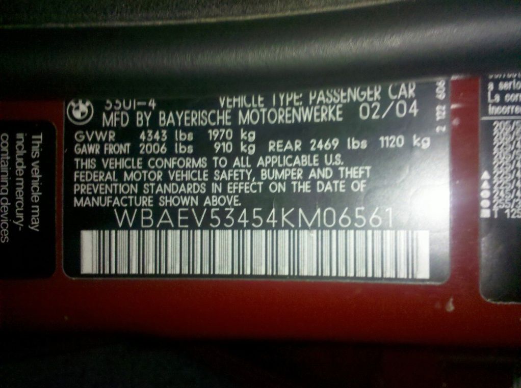

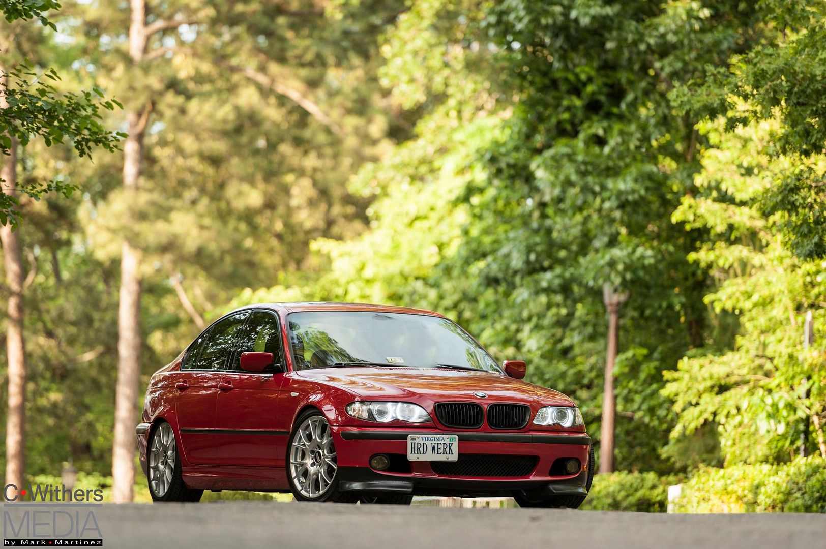

    DW77's BMW 330i ZHP Maintenance and Mod Ledger
    2004 BMW 330I ZHP MAINTENANCE LEDGER
