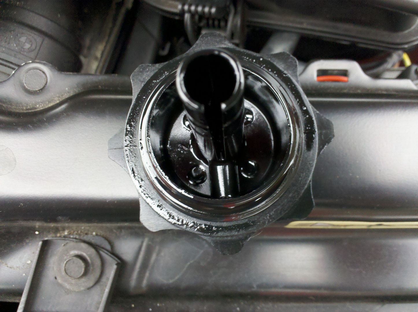

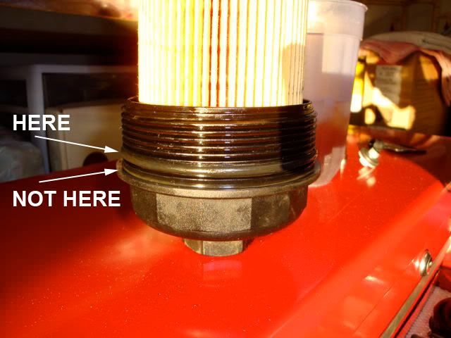

    PROPER OIL FILTER CAP O-RING LOCATION

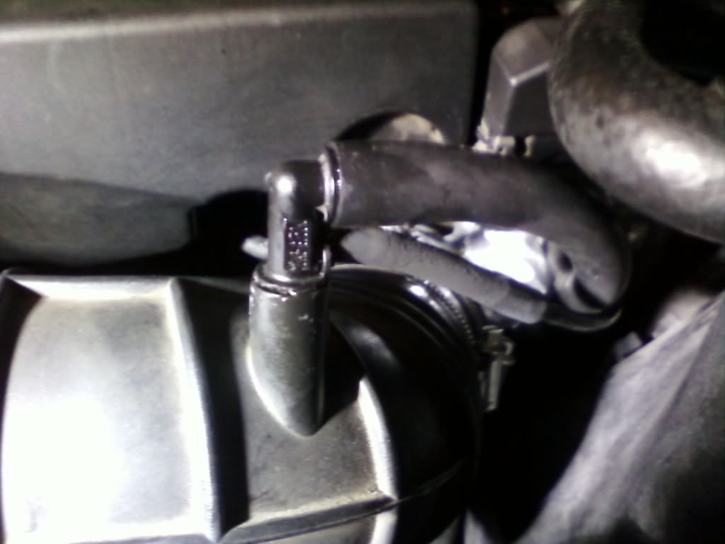

    VERY HARD PART TO FIND FROM OEM DRAWINGS-EASILY BROKEN-ONE LINE GOES TO FUEL PUMP, OTHER GOES TO BRAKE BOOSTER

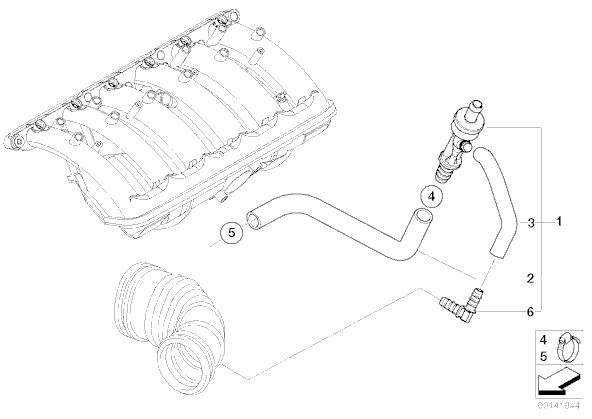

    This is the location of the above "F" fitting - and is PC 6 in the Realoem drawing (Note it looks nothing like what's installed in your car)
    http://www.realoem.com/bmw/showparts...85&hg=11&fg=45

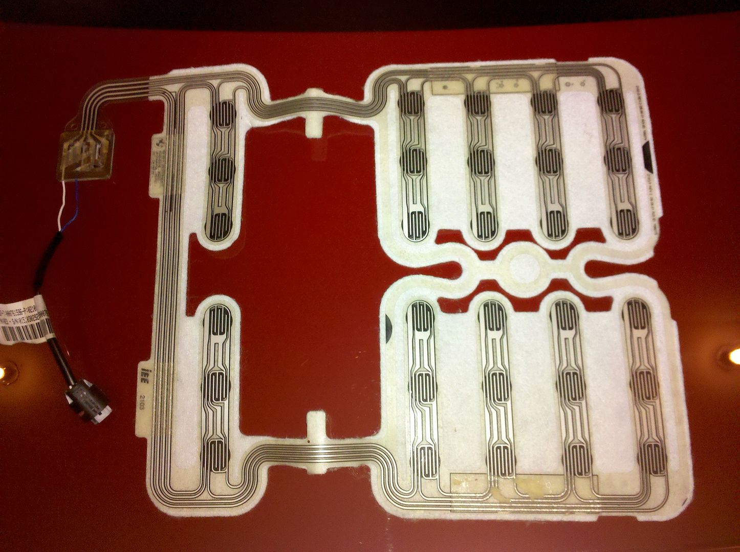

    PASSENGER SEAT OCCUPANCY SENSOR - Common cause of the SRS Airbag light and a royal PITA to change out.

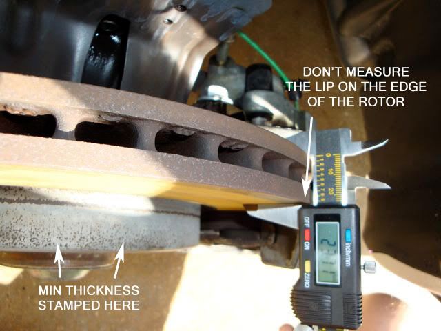

    ROTOR THICKNESS MEASUREMENTS

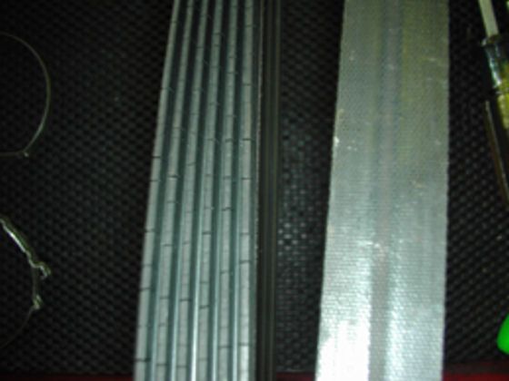

    WHAT YOUR BELTS SHOULD NOT LOOK LIKE

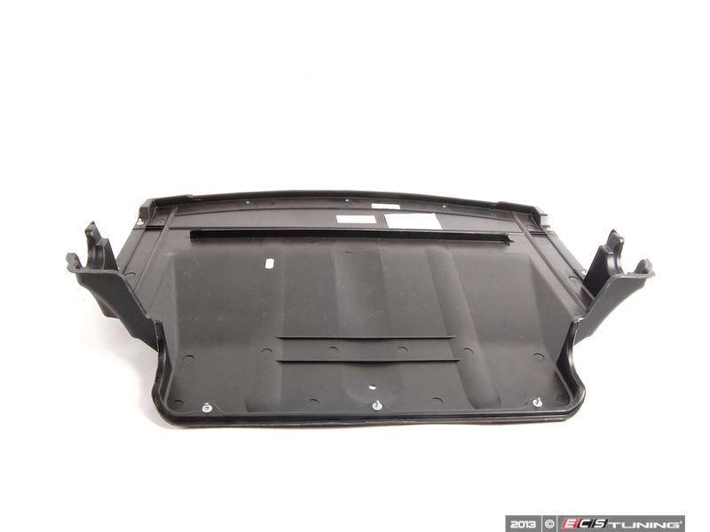

    Front splash shield
    OK. Here it is. $100.
    http://www.ecstuning.com/Search/Site..._344/ES130099/
