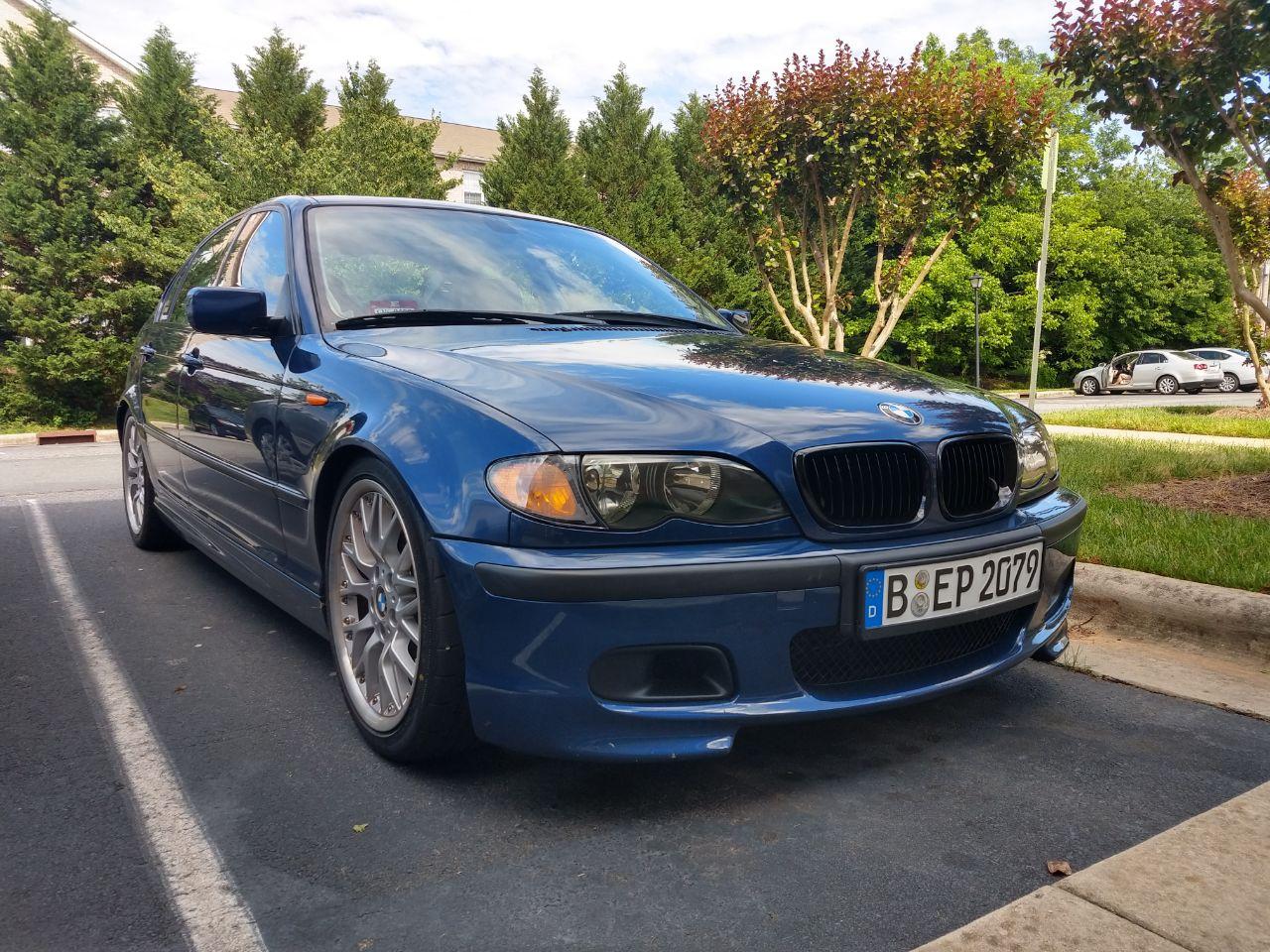

    I got some cheap ebay black grills. This must be like my 4th set because they keep breaking. Hopefully this one will last longer, it has a different mounting design than the previous ones I had.

    Yeah, when the Redish plates were done by the shop 3 years ago I think they may have crossthreaded one of the cable studs or nuts at the lever. As a result when I went to remove the nut, the cable twisted along with it. I'm also rebuilding all of the handbrake hardware (there's basically no shoe material at this point and everything is rusty), and swapping on my Zimmerman rotors, HPS pads, and ATE fluid. Honestly I think if I didn't have to do the cables I'd be nearly done at this point - slightly dropping my exhaust and removing the heatshield, then replacement of the cables (which I'm still not done) has taken me 5 hours so far.
    Where did you get those brake cooling ducts? One of my fogs has a small crack and I don't use them anyways, so I'm thinking of deleting them.

    Love the HPS pads, been running them for 1.5 years now. They haven't faded on me once, even during extreme tofu delivery I mean mountain carving.
    The foglight delete plates are these here: https://www.ebay.de/itm/BMW-3er-E46-...-/292387227511
    They don't ship internationally so I had a friend of mine ship them over. I never contacted the seller though, maybe you can arrange something.
