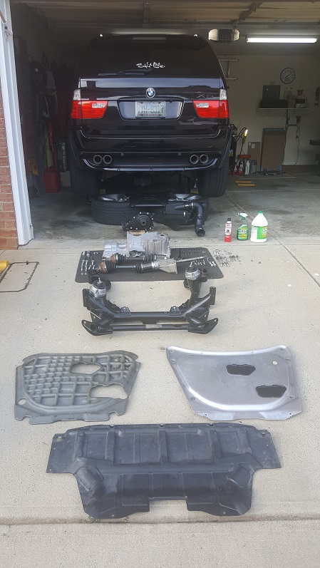

    Spent a few days finally getting around to doing the OPG on the X5. It wasn't too hard but dealing with the AWD required diff, axle and complete subframe removal. I'll never understand who thought putting the right front axle through the oil pan was a great idea. Car was up on the QuickJack and engine hanging by the Harbor Freight engine support bar for a solid week waiting on the oil to stop dripping on the left front corner where the seam requires Dreibond sealant.
    All in all glad to have it done. All back together and no leaks other than the famous GM A5S390R selector shaft seal. Tool had to be ordered from Germany so maybe next week. It's not like I'm going anywhere.
