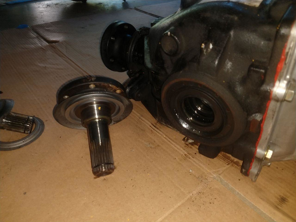

The boys and I installed the 3.38 diff that's been sitting in my corner for months. Took about 4.5h, could have been quicker but I'll take it. The difference is like night and day and the RPMs feel like exactly where they should be, which makes sense. Before I always felt they were a little low in each gear at most speeds. Very happy I didn't go with the 3.07. I swear ZHPizza's car is still punchier below 3k rpm though. Must be that ZHP magic. Guess ZHPs are special after all.
