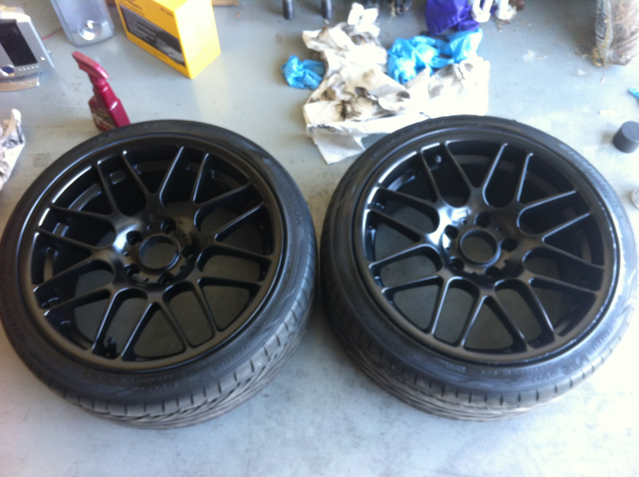

    After primer

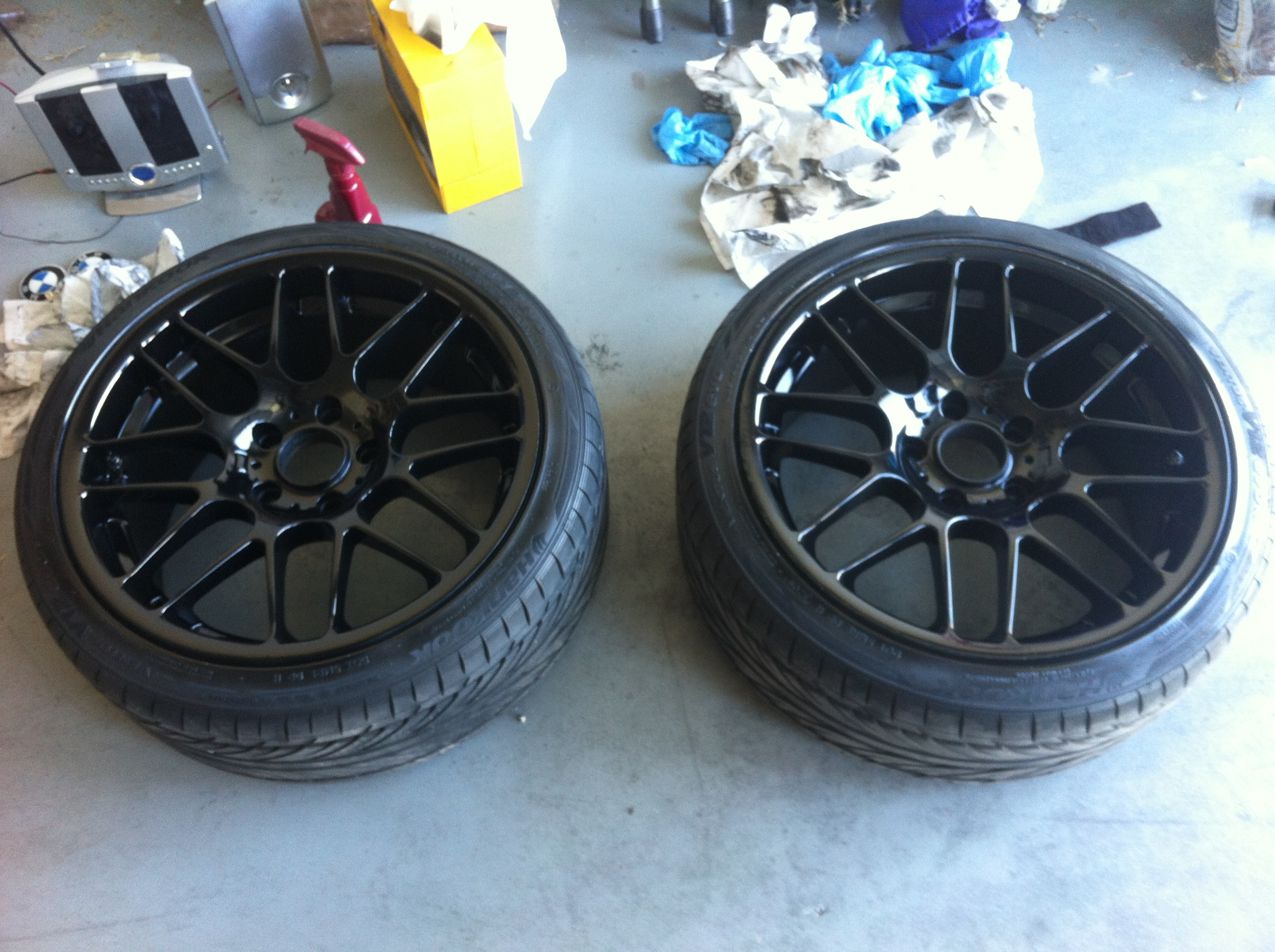

    After base coats

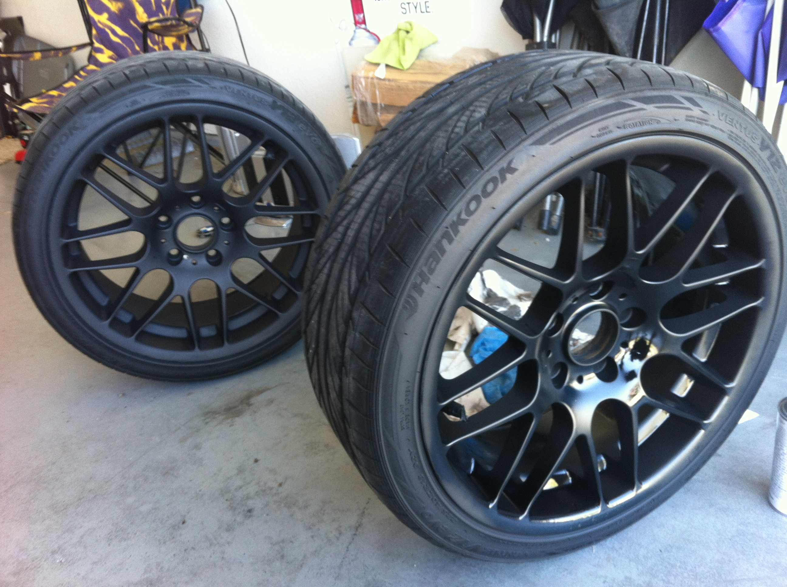

    After clear coats

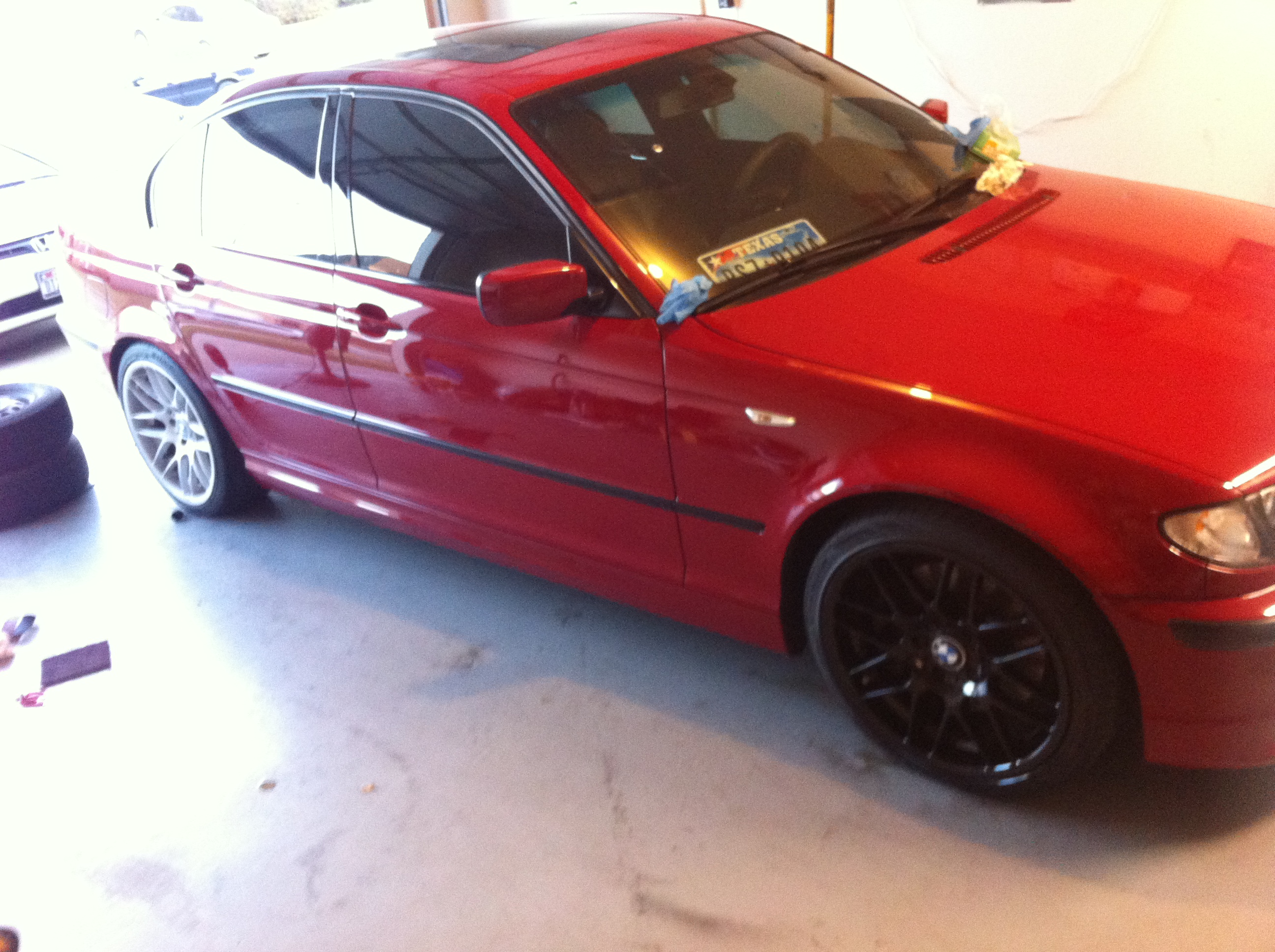

    Before and after effect. I polished them on the car the next day.
