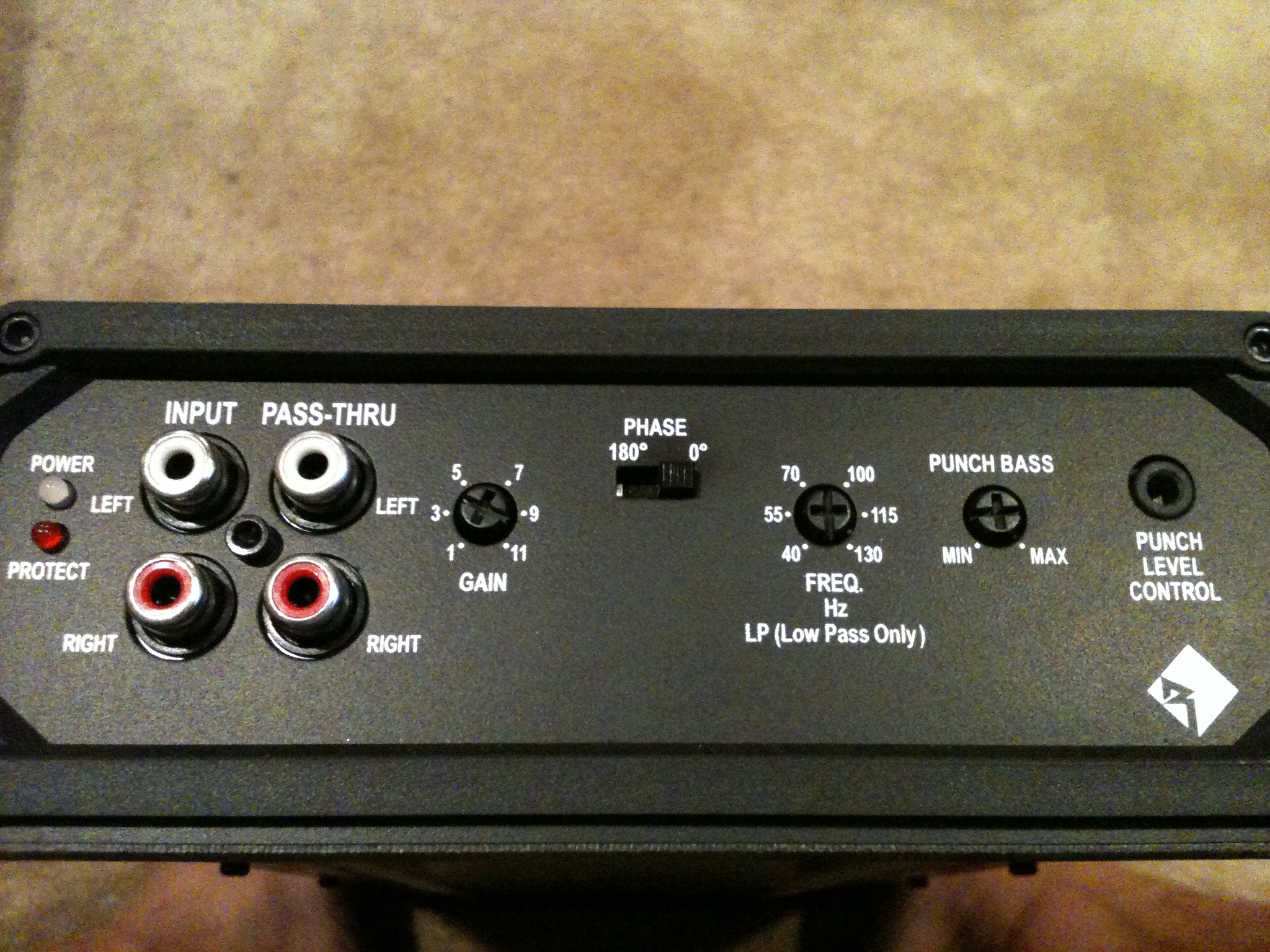

Here's the amp and inputs. Does that help. I know a little about stereos but not so much as to where I should install everything.
Google the model info and get the specs
Found this... http://www.rockfordfosgate.com/produ...item_id=112089
Can anyone help tell me what all that means and what I need to do haha?

Amp power connects to + terminal on the battery. I'll look at the converter tomorrow and get more info on it.
I think it will work, because the specs of your mom's amp state low level input.
I am pretty sure that is the same as the output of out head unit preamp.
Also see BSW website. They sell a similar amp (same manufacturer) whose specs are labelled similarly to those seen on your mom's amp. See here
You would splice into one of the input rear speakers (L or R don't matter) before it enters your current amp (BMW amp), and use that as the input to your mom's amp, hooked to the subwoofer.
You could try is without messing anything up.
