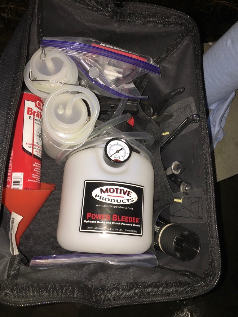

Do you guys like the kindergarten method of organization? It's my preferred method, so when I got the Motive power bleeder, I ran to Harbor Freight and picked up a 15" tool bag for around $8. I put all of my brake bleeding supplies in the bag including a caliper piston pusher, flare wrenches, 9mm nipple wrench, funnel, Motive pressure bottle and two motive bleeder bottles, plus a small OTC magnetic bleeder bottle for quick bleeds, and some steel and brass brushes, a can of Brākleen and a tube of caliper grease (not used on BMWs).
Attachment 31980
and it all zips up in a nice self-contained storage bag.
Attachment 31981
