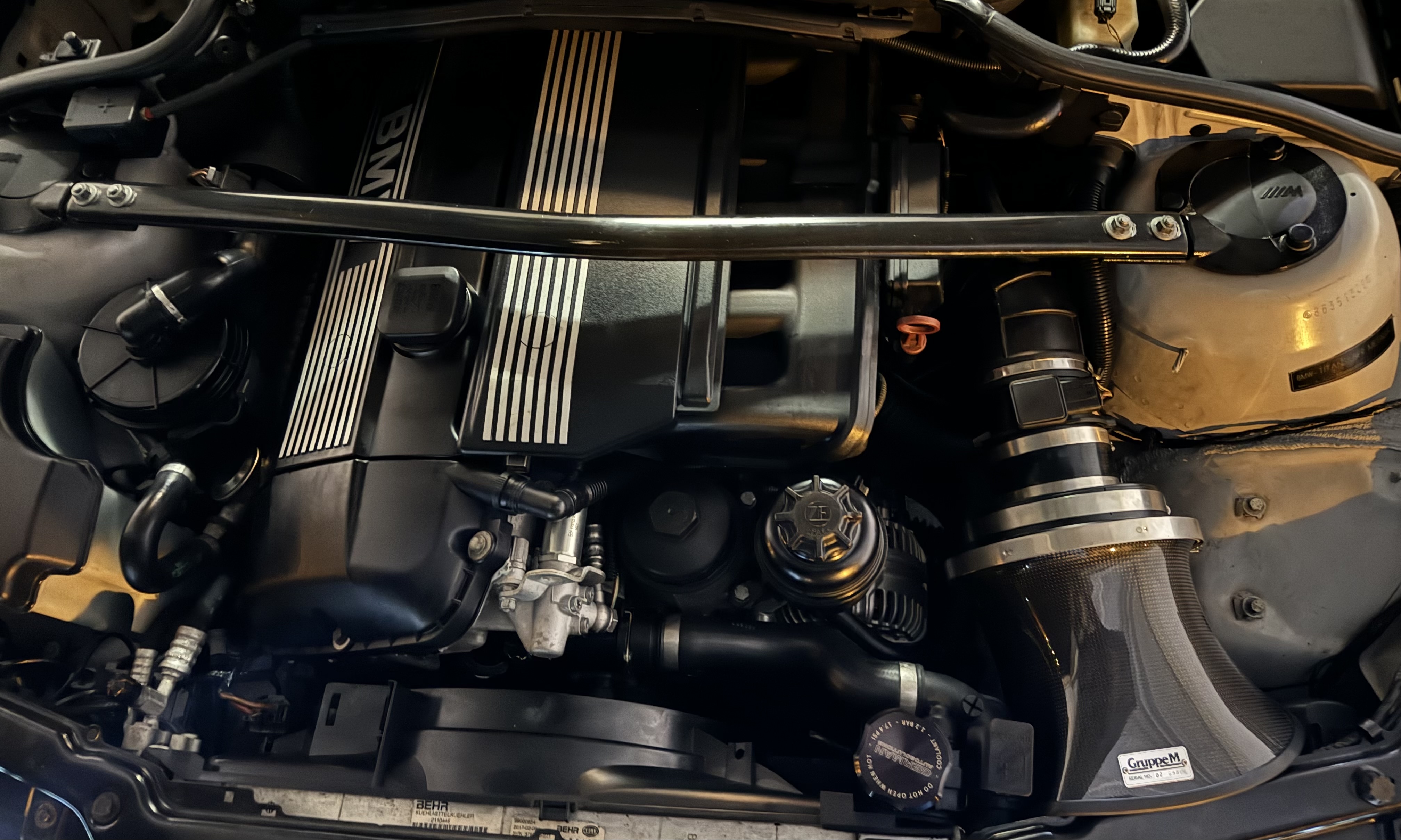

Intake thrown on because it was well past dark and I had been working on this for over 6 hours. I’ll mount the bracket tomorrow.
Attachment 40164
Gruppe M intake quick review:
She howls, I love it!
I wasn’t always a fan of how it looks, always seemed out of place to me. It’s Much better in person.

That Gruppe M intake really does look nice in your engine bay! :thumbsup
