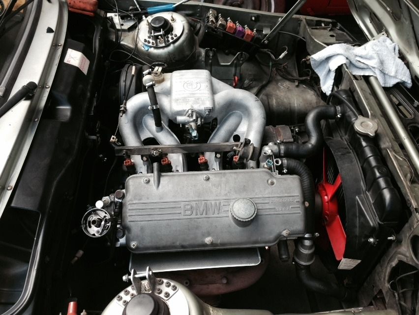

Exhaust on, tii 002 distributor installed, fuel rail on, other stuff...
http://i29.photobucket.com/albums/c2...82AC7E1DB9.jpg

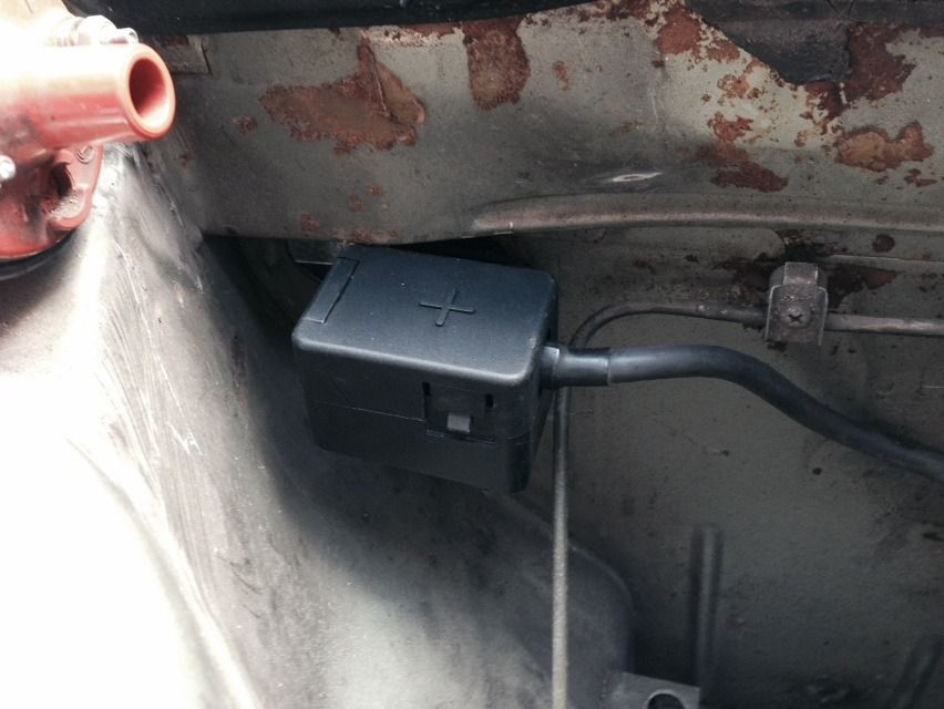

E46 cable/box finally installed correctly
http://i29.photobucket.com/albums/c2...E19F9784BC.jpg

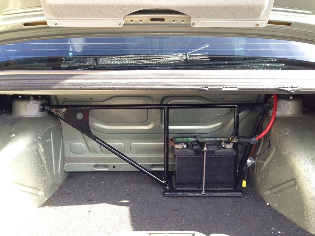

TEP brace, E46 positive cable, E38 negative cable
http://i29.photobucket.com/albums/c2...DAD84F5117.jpg

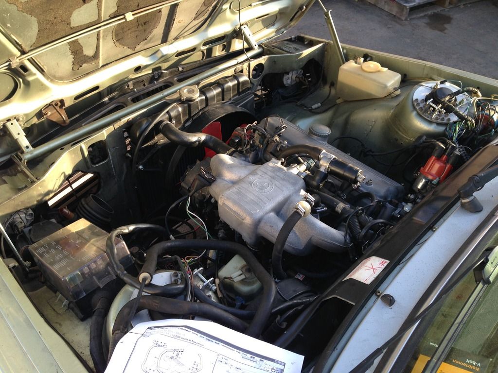

Let's see, there is air, there is gas, there is electricity, there is cooling, so, ..... ..... needs video!
and there are massive vacuum leaks ;)
ICV and assorted hoses need to be figured out. Also need to make an plate to hold the throttle cable and get a slightly longer one made. Will be using a M70 intake elbow so my car is now a mix of NK, E21, E28, E30, E32, E38, and E46

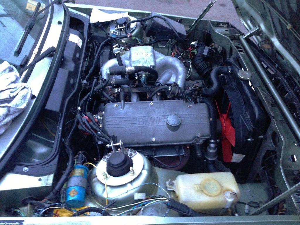

Stopped at Carl's on my way home, this is what my engine bay currently looks like
http://i29.photobucket.com/albums/c2...i/IMG_3597.jpg

I need to do a few more wiring mods and an airbox, then I should be good to go

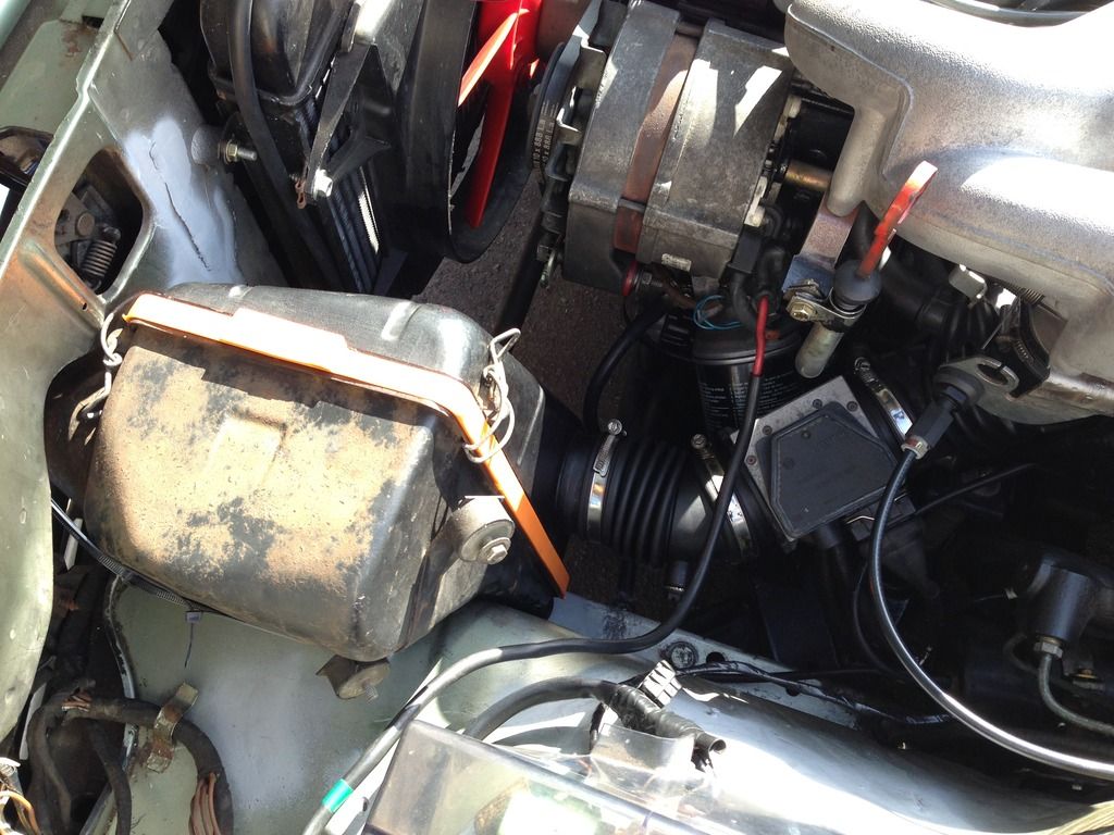

Figured out an airbox... half E21 M10, half E28 M30
http://i29.photobucket.com/albums/c2...EA9DEC4741.jpg
http://i29.photobucket.com/albums/c2...DEFBD250EF.jpg

wrapped up the harness, reinstalled the brace
http://i29.photobucket.com/albums/c2...4F6AE2EE3F.jpg

installed the charcoal canister and airbox
http://i29.photobucket.com/albums/c2...D65B5A230D.jpg

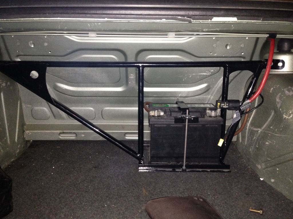

tacked the rear brace in
http://i29.photobucket.com/albums/c2...48C2C4C11B.jpg
