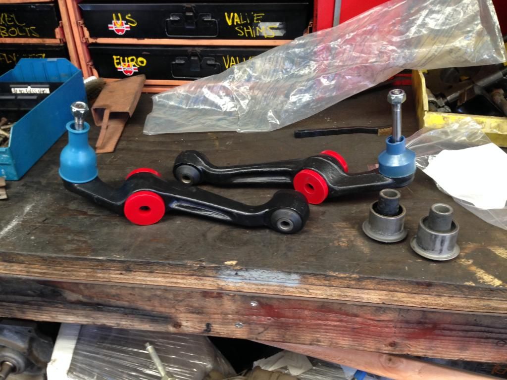

Today's progress. Refurbished the entire front suspension on the 2002
http://tapatalk.imageshack.com/v2/14...78cfb40c12.jpg
Blown front struts
http://tapatalk.imageshack.com/v2/14...15252e3a82.jpg
Trashed spring pads
http://tapatalk.imageshack.com/v2/14...f7560f99c5.jpg
Bushings beat and cracked
The aftermarket camber plates were completely devoid of grease and seized/squeaky.
Coated all metal in POR15
New tie-rods and other pivot points
http://tapatalk.imageshack.com/v2/14...b3a316ed1d.jpg
