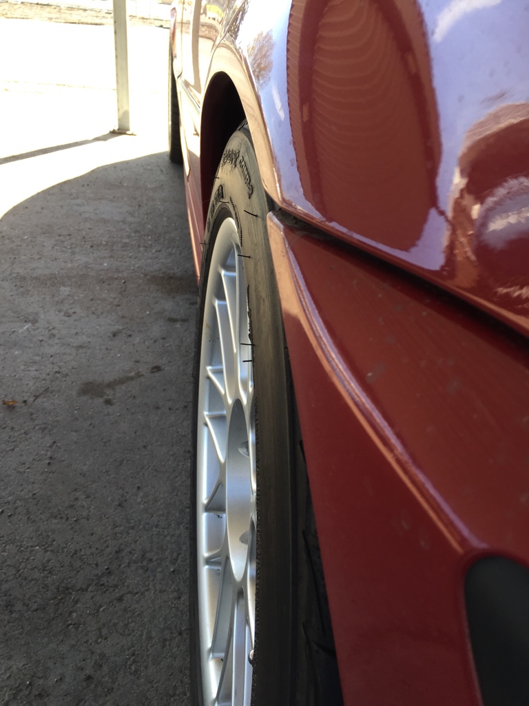

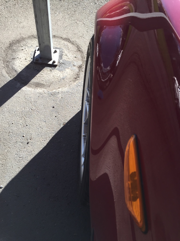

Stephen, where does it come close to rubbing, the inner wheel well, struts, or outer fender? Is it tight in front or rear or both? I have D-force LTW in 17x8.5 ET40 and they fit well on slightly lowered coilovers except for occasional rubbing areas
1) With 255mm tires, fronts rub on inner wheel well at full steering lock. Solved with 5mm spacer and going to 245mm tires.
2) With 255mm tires, rears rub on upper outer fender in hard turns. Initially solved by raising rear ride height slightly, currently solved with stiffer rear springs and using 245mm tires instead of 255.
I do have more negative camber than stock in front (-2.5 to -3.5 depending on plate settings), -2.0 degrees in rear. I think the 17x9" wheels are ET42. If I run them with 255mm tires, I expect I'll need 12mm spacers in front plus keep the wheels from rubbing the inner wheel well wall. Not sure how I'll avoid rubbing in back, maybe keep the stiffer springs with slightly higher ride height? Or make rear camber -2.2 degrees? But I know it can be done.

Front - wheel itself is pretty close to edge of fender. 245/40/17
Attachment 16494
Rear - probably a bit extra room if the correct tire size was on. But the edge of the wheel is right to the outer edge of the fender. 245/45/17
Attachment 16493
