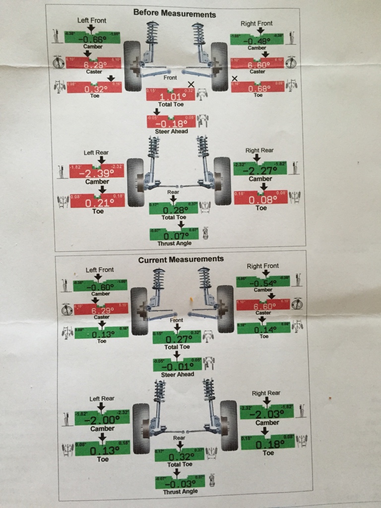

Alignment complete. Caster out due to Z4M FCABs.
Attachment 19444
Nice. How does it drive now?

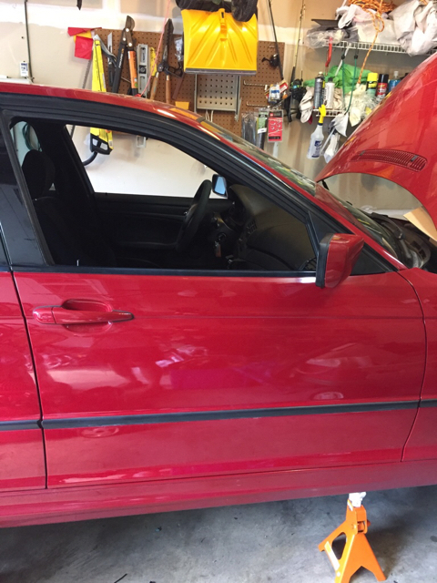

New door installed with new window regulator.
Attachment 19530
Looks good.

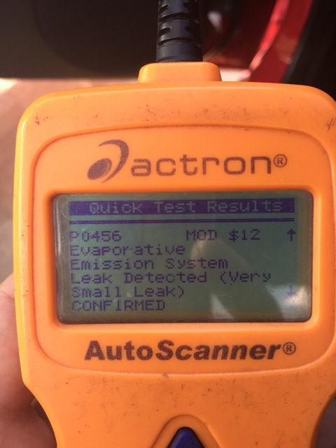

Codes p0442 and p0456. I'm hoping it's the gas cap. I'll order two as I checked Colin's and the o-ring on his is cracked like mine.

Nice. Did you ever figure out what those codes were?
Besides the codes, other symptoms ? On my first e46, the SES came on. Also, at the gas station the pump stopped multiple times while filling up. One mechanic said to change the gas cap. No luck.
The dealer said it was charcoal canister, IIRC.

Installed new gas cap and cleared codes. Hope they stay gone.
