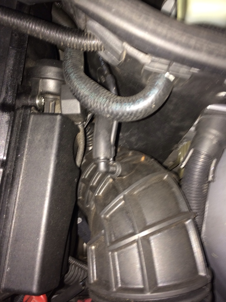

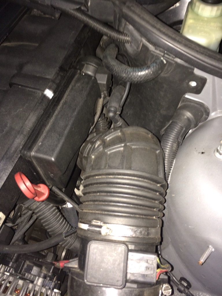

Could be the pan, but might be worth checking for a source higher up. The X5 3.0 (M54) I just worked on had a leaking crimp on the VANOS oil line that was causing oil to drip down onto the seam, making it look like a leak all around the front and left side of the pan.
