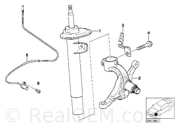

Noise diagnosis: Backing out of the driveway this morning I heard a single click/pop as I turned the wheel. Each of the 4 righthand turns between the house and office were also accompanied by a single pop. (Edit: it does not make this sound when turning left).
I'm going to check the end links during lunch, but what are my other possible culprits? CV? I have tie rods waiting to go in, as I'm trying to resolve some wheel vibration at 50mph+. Any advice is welcome. Thanks, gentlemen.
did you install those front konis yet?
sounds like a ball joint or tie rod end. both are original as they were in good shape at that point. it's not going to be a CV as your car is RWD. ;)
i replaced the end links and FCABs last summer - doubtful that the FCABs are the issue, as that's not a symptom of FCAB failure... wheel jerk under light braking is the dead giveaway.
