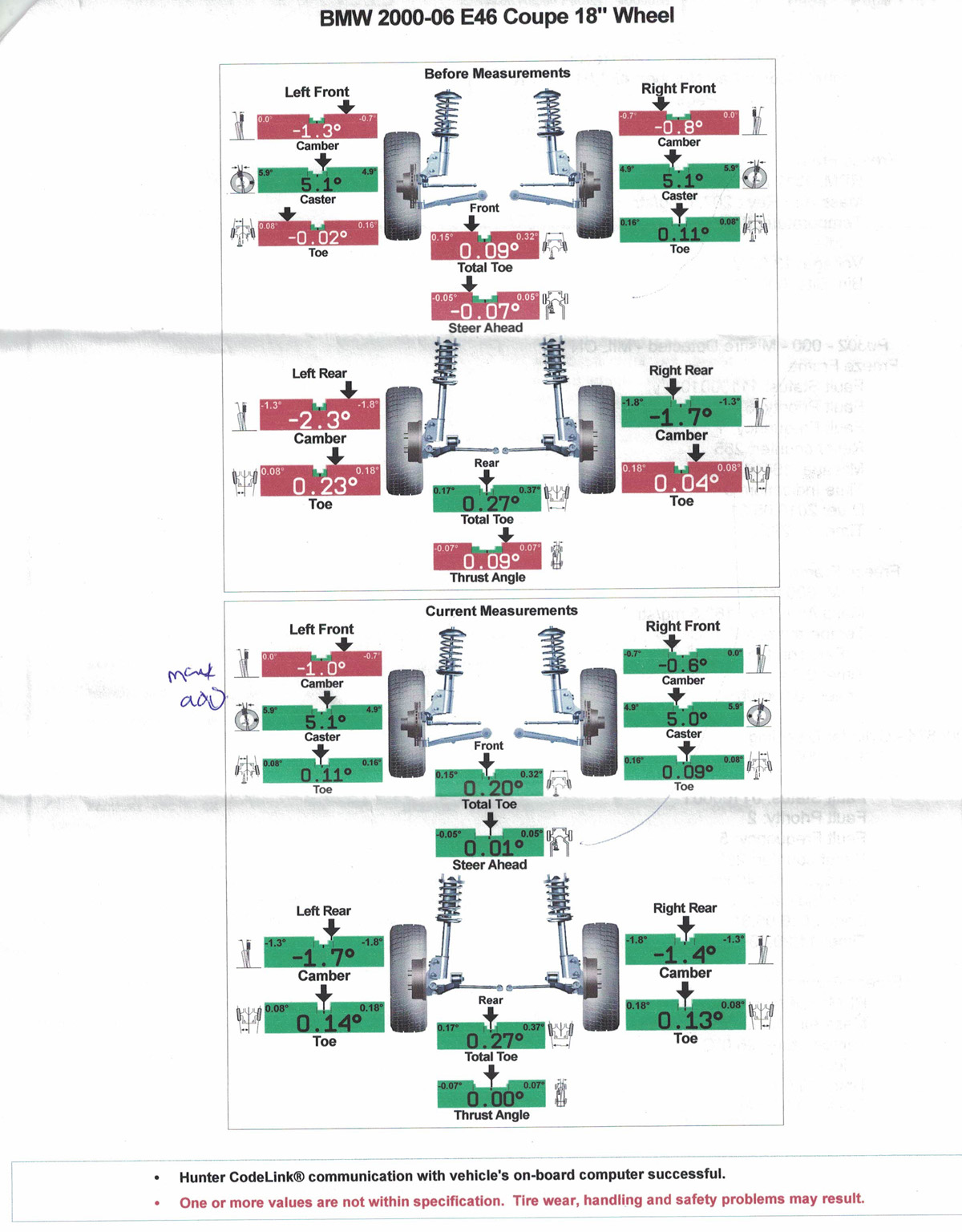

This is the story: Earlier this year I had good luck and won a free alignment with one of our Chapter's sponsors, Shade Tree Garage. I have an '06 ZHP Coupe with 162k miles and was planning to refresh the suspension, so getting an alignment was on the list. For options, I read up on this site, talked to other club members and based on my goals, I went with Koni Yellow (set to 1/3 stiff) with Eibach springs and had the shop do the alignment. Below is the printout from the Hunter machine and it seems quite good.
Turn-in response is much quicker but seems non-linear and road bumps are a touch sharper; all of this is OK with me. I also have new rear PSS and the FCBs were replaces a year ago. The questions here are: why the non-linear response and also, in high-speed sweepers the car needs a steady hand like it is on the edge, when it should feel planted. Ideas?

Alignment time!
Done 7/7/2016 at Bullet Performance in Costa Mesa. If you need a PDF of this, just click the image.
