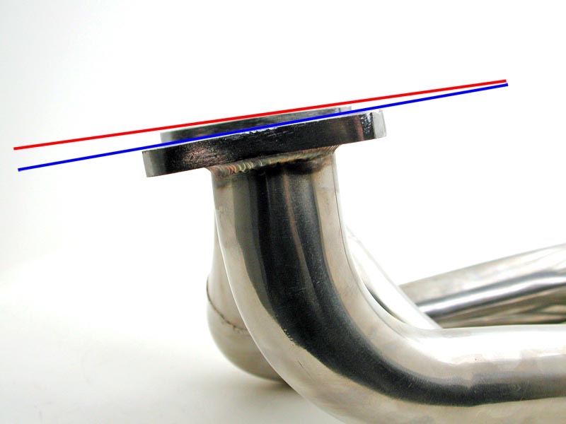

I realize this is why these were cheap, but it seems pretty darn minor with ~1.4-1.5mm gap/tilt. Am I wrong? Will this actually be major? I'm used to seeing this from cheap headers:
Attachment 18407
Attachment 18408
sean, put them in a jig/vise and then torch the tube needing adjustment and bend it ever-so-carefully. had to do this once before, worked perfectly.

Good move. Pick up the CSL headers and no headaches will be had.
