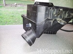

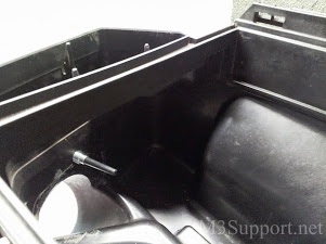

3 Attachment(s)
Quote:
Originally Posted by
GE Geoff
Coolant Temp Sensor Charlie?
AIT Relocation Kit for the ///M. This mod moved the sensor down into the air filter box to keep it from getting heat soaked. I did this to mine and it was a noticeable difference. The intake air temp reads closer to the actual outside temp with this also.
Oh and Welcome Charlie...[emoji106]
Attachment 18535
Attachment 18536
Attachment 18537
