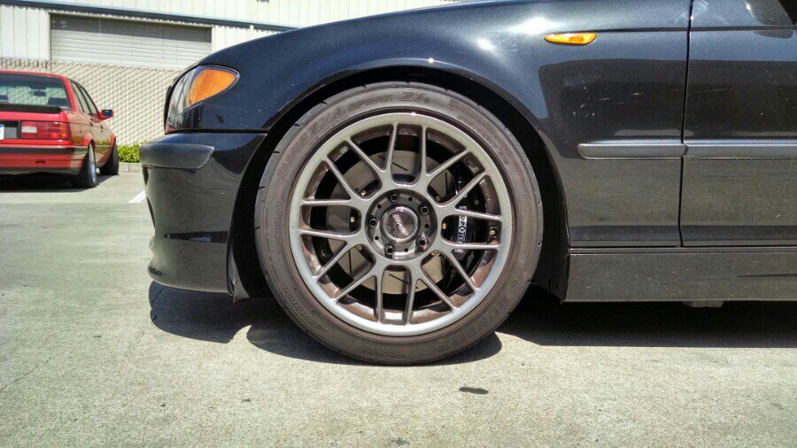

Here are some pics of the completed work:
Attachment 13514
Attachment 13515
Attachment 13516
Matt, Stephen, Dillon and Ernesto do awesome work! Thanks to Performance Technic for the wonderful quick install.

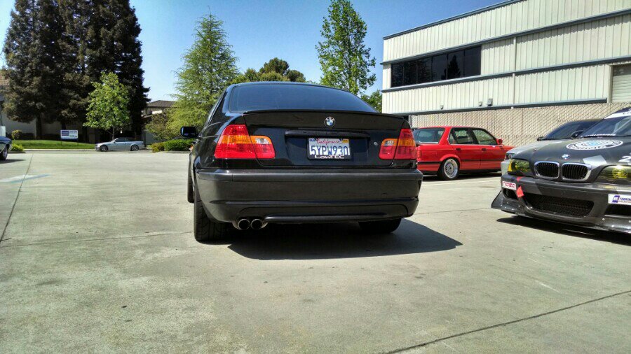

Matt installed the BBK. There was some bad news regarding the rear camber bolt. It is literally stuck in there and the only way out is to replace the ball joint and the camber arms. At least Matt was able to free the bolt and let it adjust. I plan on getting some camber arms by SBC and get that done next time.
The 12.5mm Spacer is in the front for now. I haven't decided what to do with the spacer issue just yet. The rear is sunken way too in.

Matt and Stephen @ P-Tech were complimenting the car. They enjoyed the mods when they test drove it and like the readiness of the 3.62 final drive and the handling and comfort from my swift spring/groundcontrol setup. Now with the new brakes, this car is going to be more consistent at the track! Now to get rid of the funky front wheels sticking out at the front and the rears sunk in.
I think I have a few options:
- 7.5mm TMS spacers + Hub Extenders
- 10mm/F 12.5mm/R
- 12.5mm/F 12.5mm/R
What's your guy's opinions on this?
