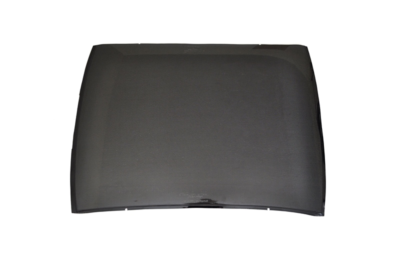

ugh... someone talk me out of this.... Sedan CF roof skin (replaced the steel roof) in CSL weave
about $722.93 + shipping from over seas. its the same guys that make the CF airbox going on my car.
im shooting for this for next year.
https://www.geoffsteel.co.uk/shop/e4...r-roof-skin-3/

Thats an awesome price but if shipping becomes astronomical, i came across these guys here in the states. I almost bought their s54 sedan.
https://store.langracing.com/bmw-e46...er-roof-panel/
