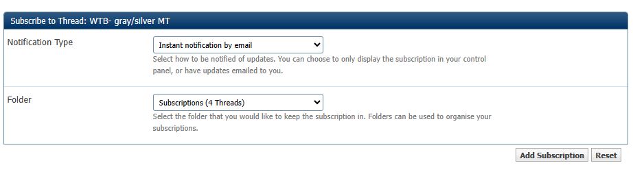

I don't see the above screen on my side. Are you using Tapatalk? This is how I subscribed on the desktop version:
1. Open thread
2. Goto Thread Tools > Subscribe to this Thread
3. This screen shows:
Attachment 40090

That is how mine is set too. I actually got locked out of my account messing with some settings yesterday. Dane got it reset this morning and maybe thats fixed the email notifications too.

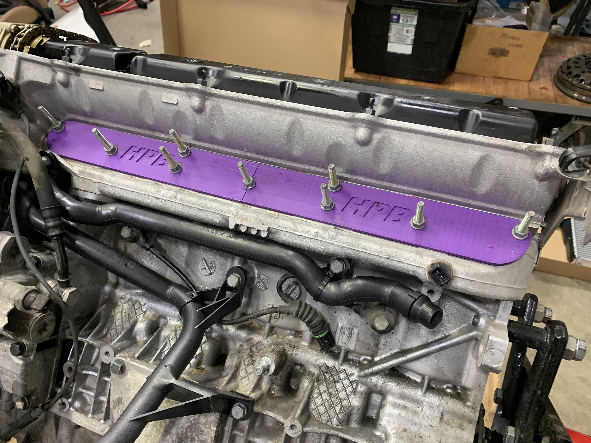

Pardon my ignorance, what is this HPB part?
Attachment 40651
Fredo,
Its just a 3d printed part I make to cover up openings in the engine and accessories when I'm cleaning them. Here's some more pics of other ones.
