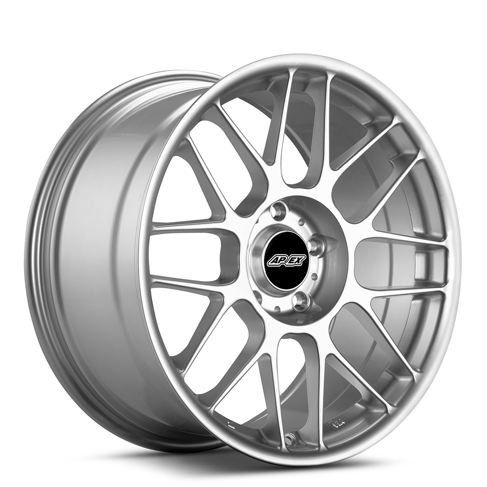

joined the GB for some of this goodness. :)
:cheers
Attachment 25088
Those things look good! I was very tempted to join that GB as well...
there's still time! and it has already reached $200 off + free shipping - go for it! these suckers are 18.4lbs each - that's almost 2lbs lighter than my 17" Style 68s! woohoo!
Nice! I'm sure you'll love them. Are you going with a square setup or staggered?
EDIT: I thought Style 68s were closer to 21 and 22 lbs front/rear.
they're about 20.5lbs front, 21lbs rear. on my scale anyway...
yep, square setup - 18x8.5 ET38.
i considered going 18x8.5 ET38 and 18x9 ET42, but that's effectively ET36 for an 8.5" wheel, which with a 255/35/18 tire at my camber settings, would rub - badly. so i'm going square with a 235/40/18 tire. might try out some koni yellows and stock springs with them, too... :ninja
