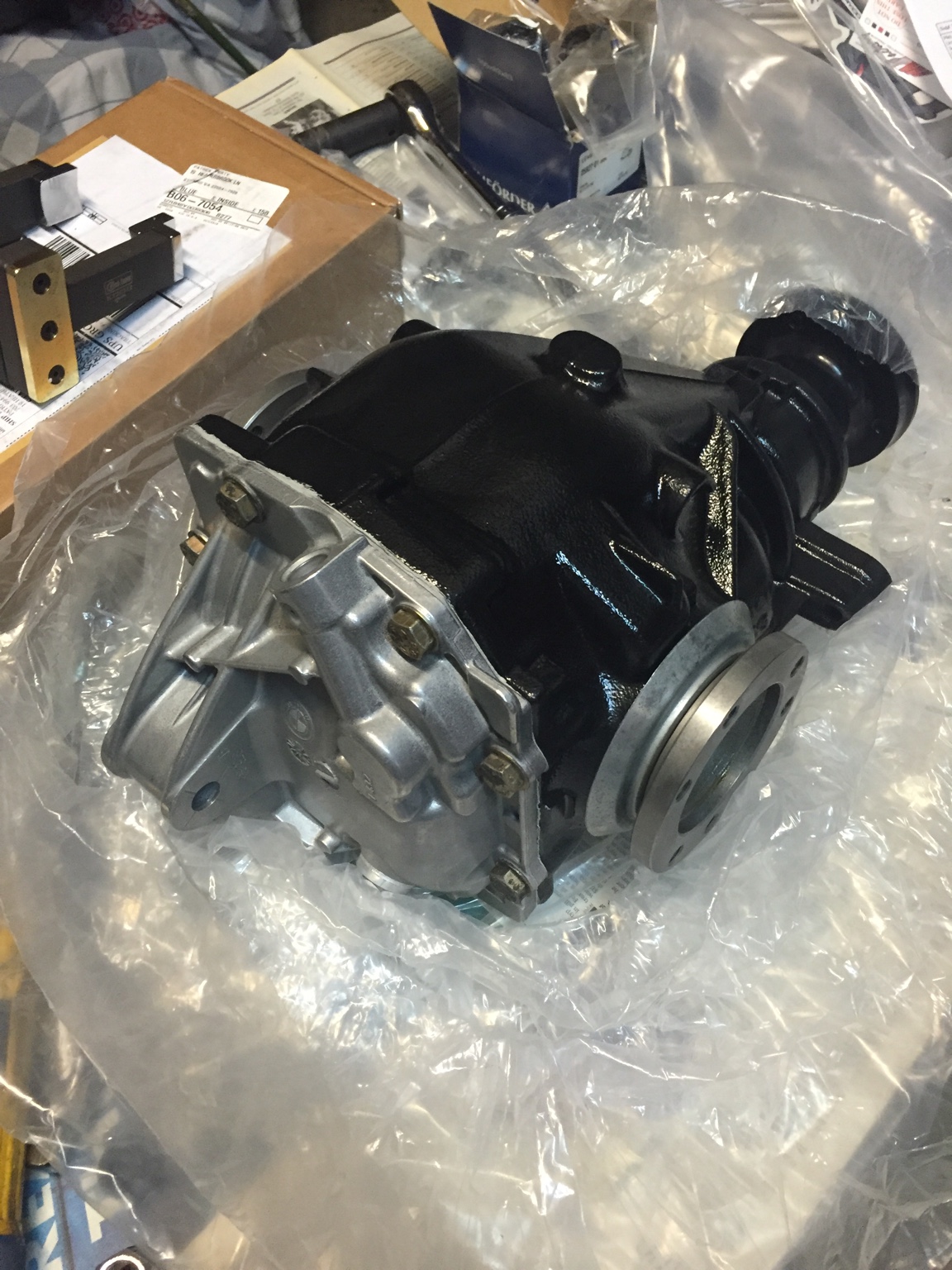

LSD is anxiously awaiting install.

Killing it
