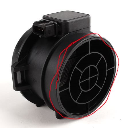

I seem to have some more missing plastic in my MAF too. Didn't really think too much until I started looking at MAF pictures online. I don't seem to have the plastic guard with the BMW logo. I'm not sure what happened there or recall if I saw it there before. Uhhh.... :scratchinghead
This guy on youtube also had his go missing.
https://www.youtube.com/watch?v=XkOSFYeG90g
Are you talking about this part?
Attachment 31468
It seems to be pictured on all the MAFs, though there's a real possibility that's not a bmw symbol.
No, I thought you were referring to the top flat part where the connector goes in. My bad.
