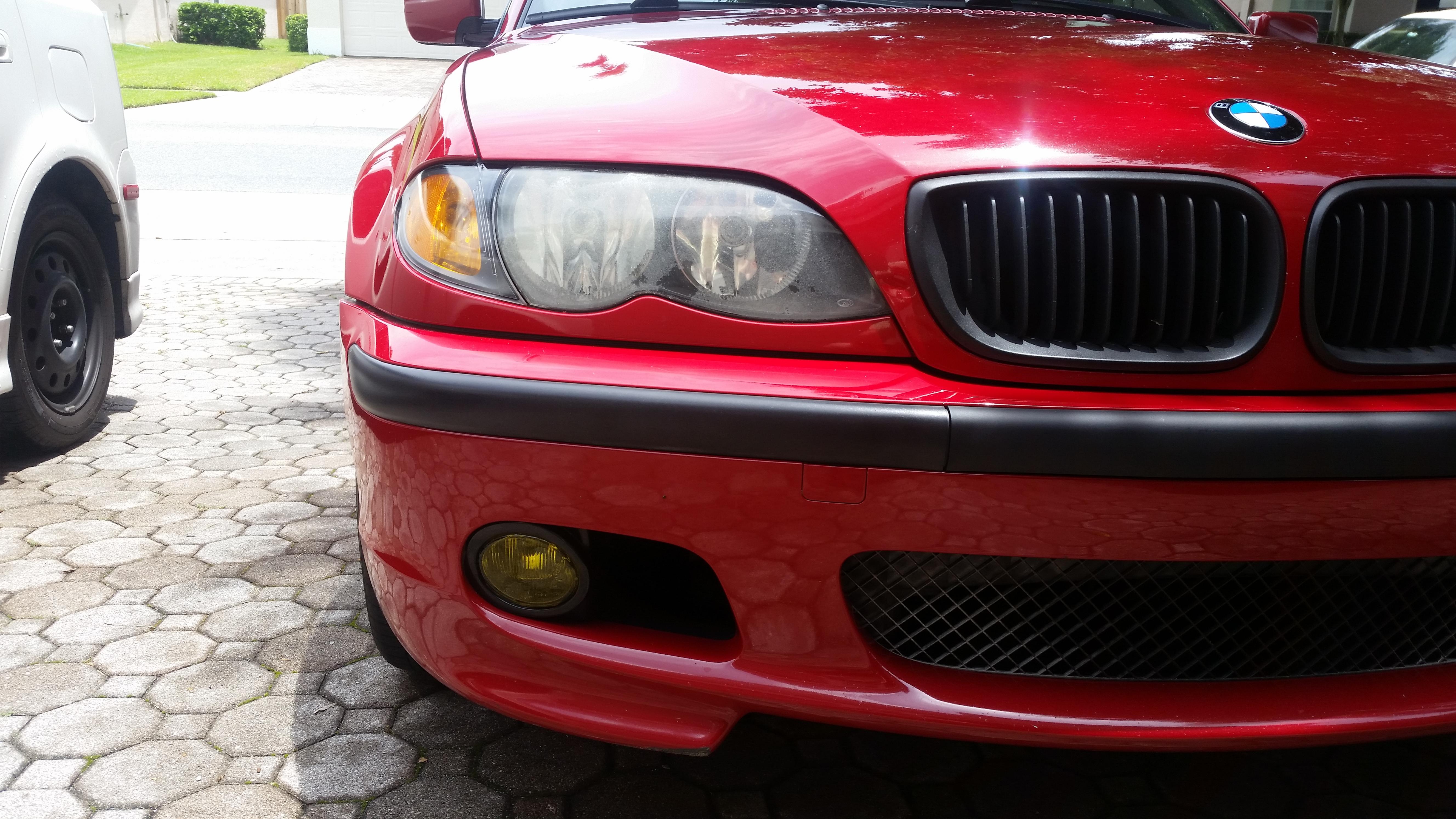

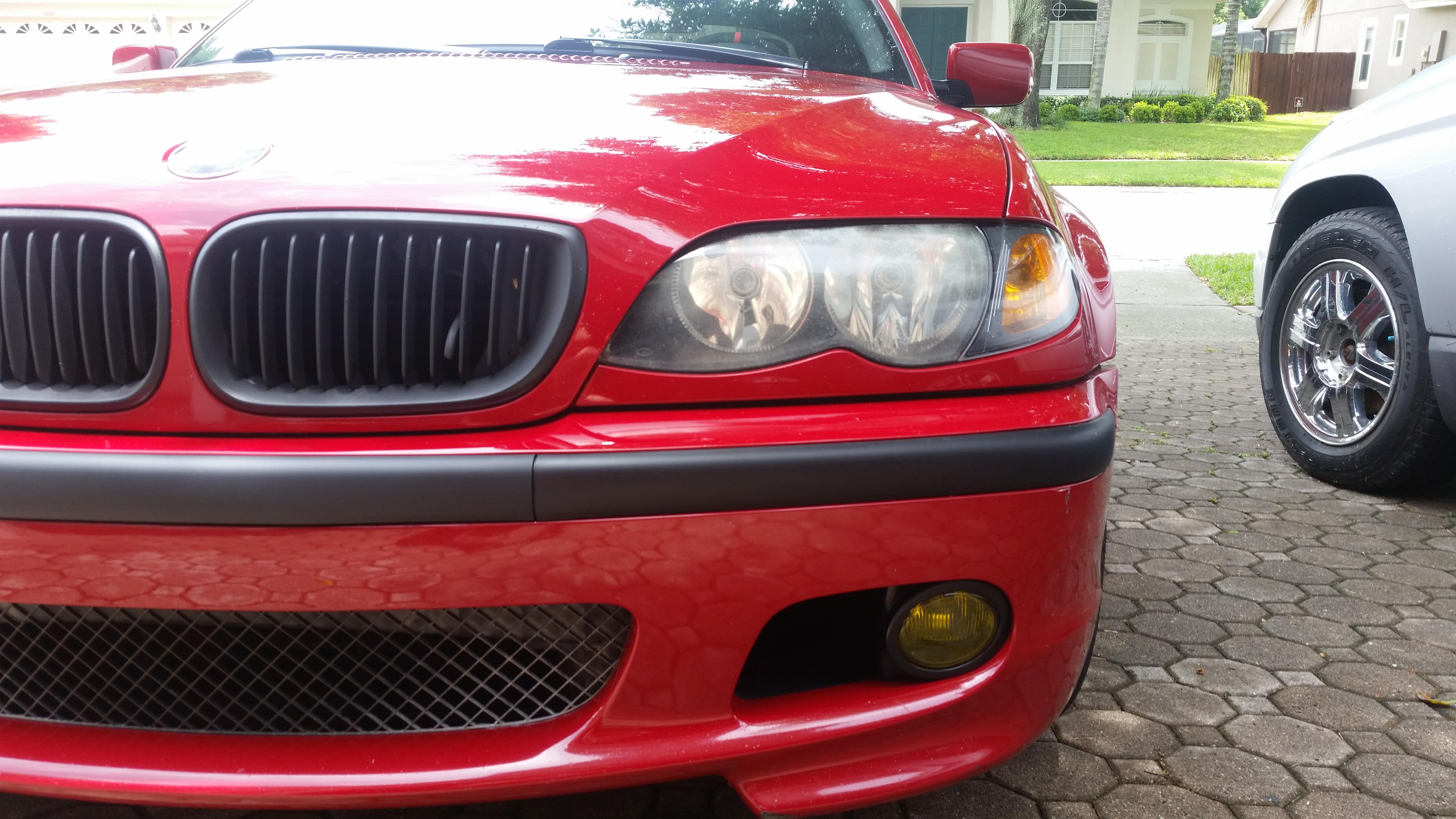

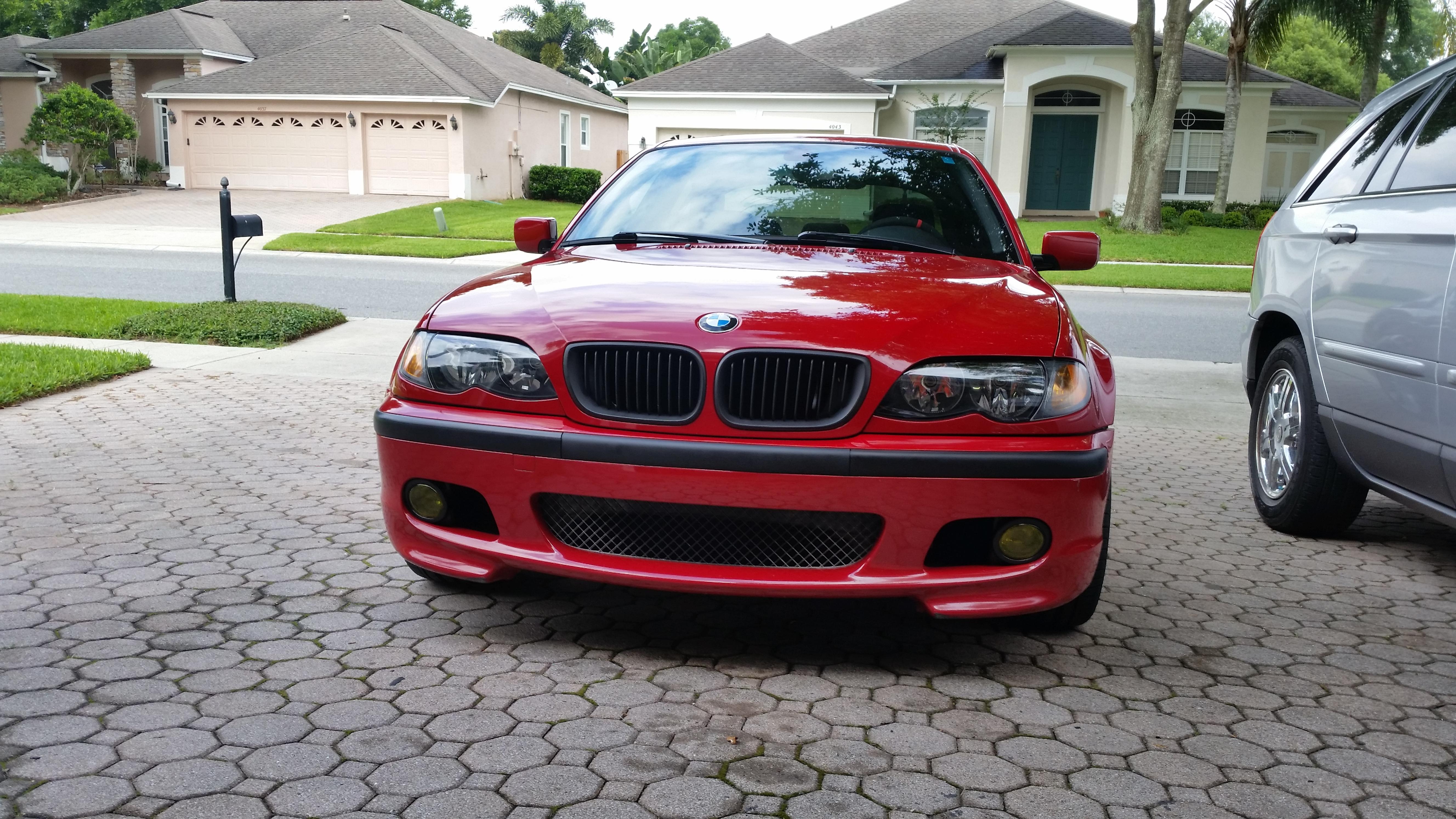

Installed new lenses I got from Khoalty. Install was simple. In my eyes, it is a whole new car!!!
Before:
Attachment 19745
Attachment 19746
Attachment 19747
After:
Attachment 19748
Attachment 19749
Attachment 19750
Did you bother with the seals?/ I'm thinking they are fine.
