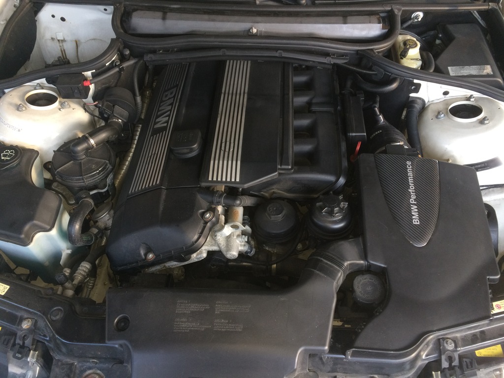

Did almost the same thing. Installed the Stett Performance boots and found out my DISA was bad so I installed the GAS rebuild as soon as I could. Then installed the BMW Performance intake.
Lower boot installed:

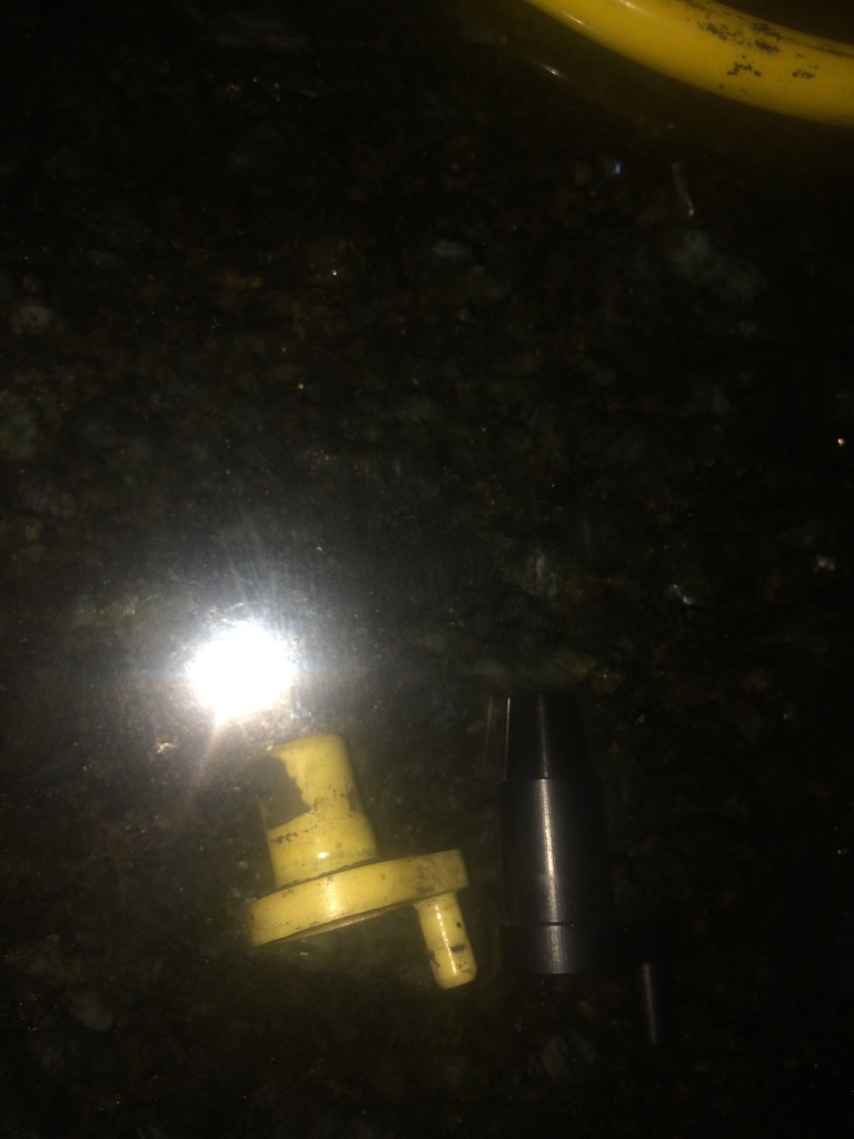

Snapped a hose on the f-connector when taking the upper boot back off to fix the DISA:
Attachment 20213
Luckily it was just a rubber connector and not the actual hose or f-connector that broke; easy fix.

All buttoned up:
Attachment 20217
Attachment 20218
No more sputtering idle or SEL.
Nice man! I actually broke a piece off of my f connector and it wasn't salvageable but my buddy had an extra. Definitely got lucky!
