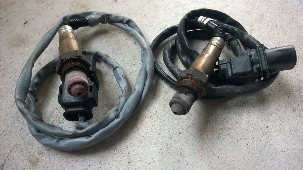

Replaced pre-cat O2 sensors. I guess I know why I was getting weird deviations in O2 sensor voltage between bank 1 and 2...
http://i1113.photobucket.com/albums/...mporary_23.jpg
Should run much better now.

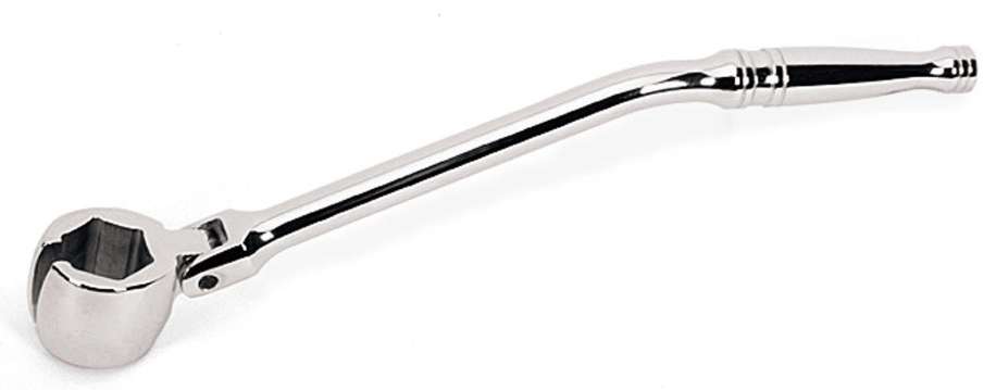

And, since I have headers, it would have been impossible without this by the way:
Attachment 21642
^ glad you got them done. Hope it helps.

Got mine from Amazon, like $20, worth every penny. Only way I could get the right angles in there to get the sensors out. Worked really quite well.
Thanks, it sure did, Pre-cat O2 voltages are right on between bank 1 and 2, no more wild deviations. Car seems run real good.
