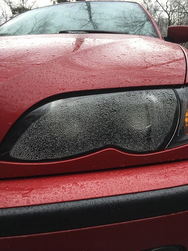

Found my car today to have condensation on the left headlight....like, a lot. How critical is it to fix this? I imagine my seals / gaskets are leaking at which time i'd change the lenses as well, but is it something i can take my time doing or want to tackle asap as to not ruin the xenons?
I would definitely get the water out as soon as possible, you might get some corrosion or even discoloraiton depending on how long you let the water sit and how much is in there.
Do you have a sedan? If you do maybe check the tabs and make sure everything is seated properly. Could be a simple fix without having to buy anything.
OK, i brought the car in the garage and will try to start taking it apart (thank you, Youtube)
Here is the headlight. All that water you see is on the inside :(

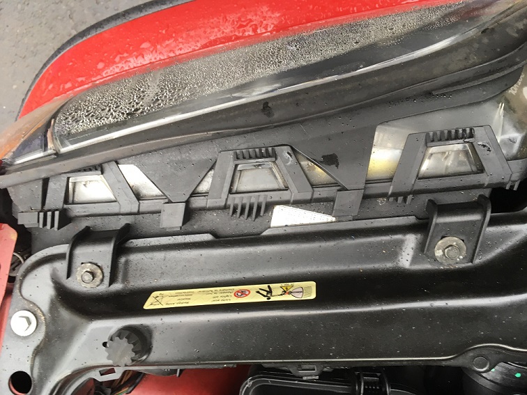

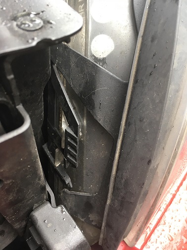

I checked the tabs and they all seem sealed properly, even the rubber piece sitting atop the headlight.

I have new lenses from Kohalty but not the gaskets / seals. I assume just get them at the same place?
Headlight lens gasket:
Part number: 63128380210
They're about $25 online.
https://www.fcpeuro.com/products/bmw...380210#fitment (for some reason says it's not compatible with 04/05 sedan but RealOEM says it is)
https://www.ecstuning.com/b-genuine-...h/63128380210/ -- same P/N from ECS, which says it's compatible
