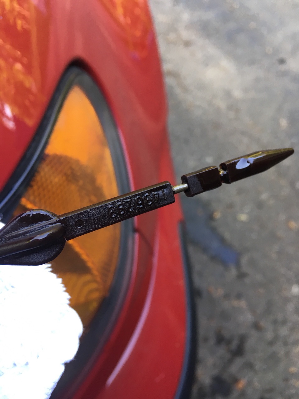

How low does this represent? Attachment 32992
AFAIK it’s about half a quart, although my low level light would be triggered 1/3 of the time by that oil level
Looks like about .4 quarts, which is completely fine. You want the level to be somewhere on the rectangle.
Interesting that within the required range to the light would go on. I’ll check level again before i drive it to the shop but looks like it’d be fine for that short drive.
If the surface is level then the sensor could be off. I guess the other option would be that the dipstick is wrong.
