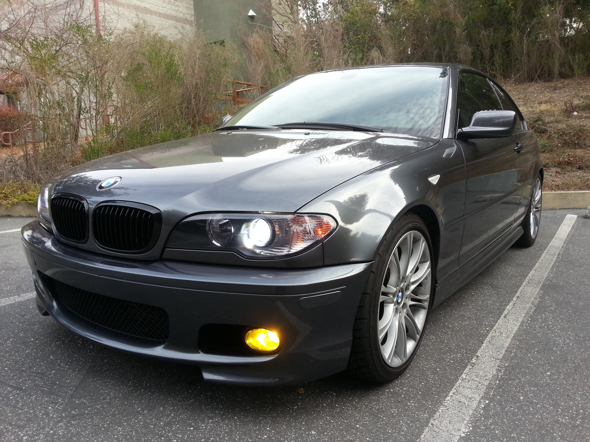

New sig is sweet! Love the yellow fogs, I need to jump ship.
Thanks! The yellow effect was achieved through a yellow 3500k halogen bulb and yellow Lamin-x protector film. I didn't think it would come out so well so I was planning on doing HID in the future but I'm pretty sure I'm sticking with this set up.
