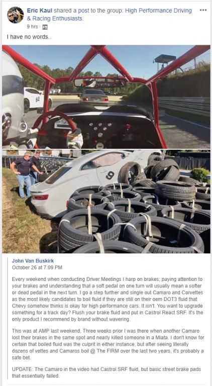

I saw a Facebook post this morning that shows the dangers of stock pads as you get faster, even with good fluid.
Attachment 34195
I'm not sure I can save the video from Facebook, but let's just say the guy almost killed a Miata driver about to take a turn when it just plowed straight past (in front of) him, off the track, and into the wall.
