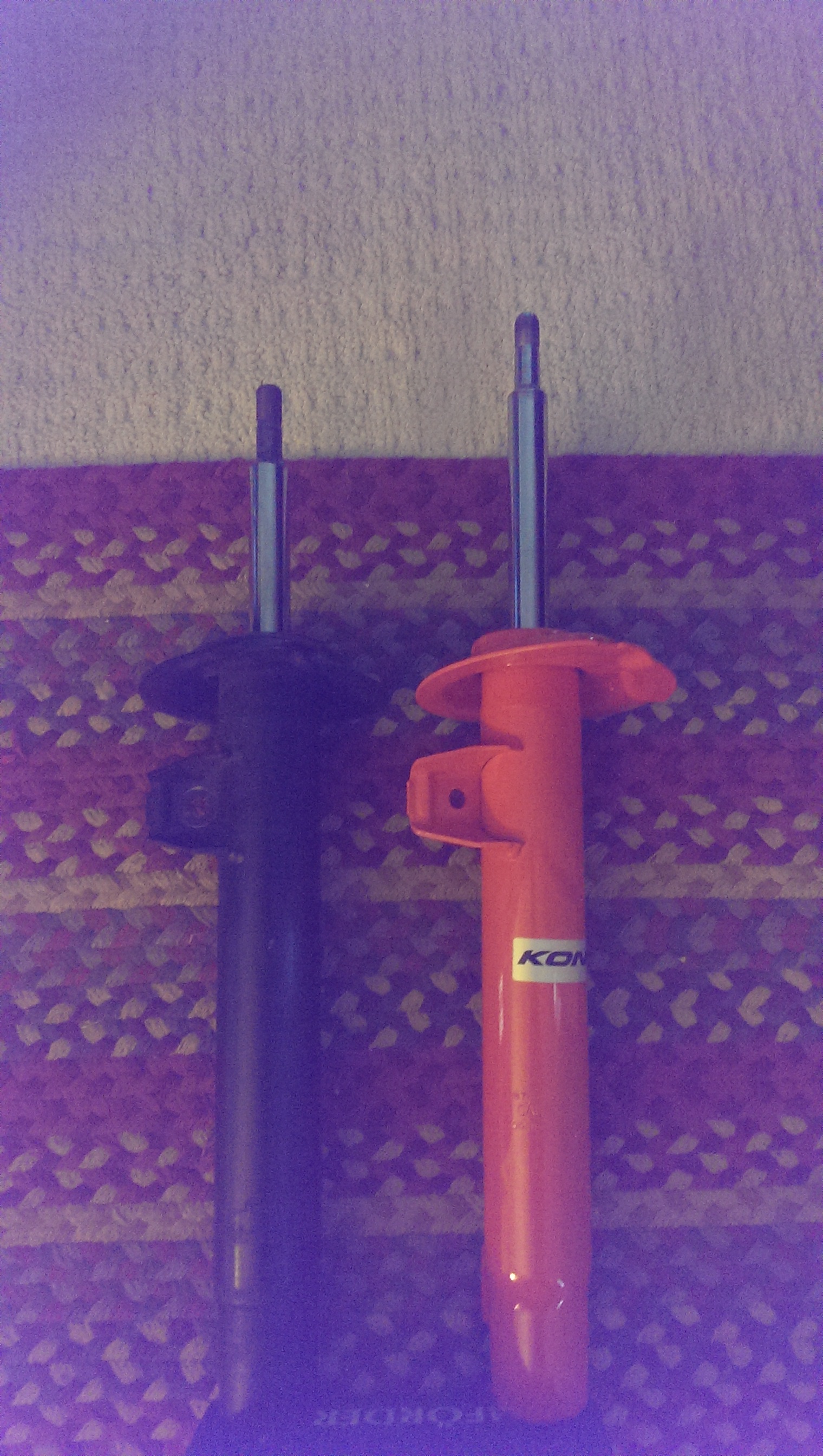

Wrong again, the Koni STR.T will not fit:
Attachment 20775
Attachment 20775
I am not used to playing with suspension stuff at all but clearly, at rest, the Koni is one inch too tall.
The problem is that the original BMW shock on the left can be extended up maybe 1/4 of an inch.
The koni on the right, at least a solid inch.
In the end, with the coils relaxed, there is a 2 inch difference and the Koni can not fit (see pics several posts above).
Getting the KYB Excel-G FedExed ...

The KYB Excel-G arrived today! And....they fit! In a side by side comparison, the KYB Excel-G are almost an exact replica of the original BMW shock. The Koni Str.T were not by a long shot.
They are a little taller than the original but not as tall as the Koni STR.T with springs relaxed.
