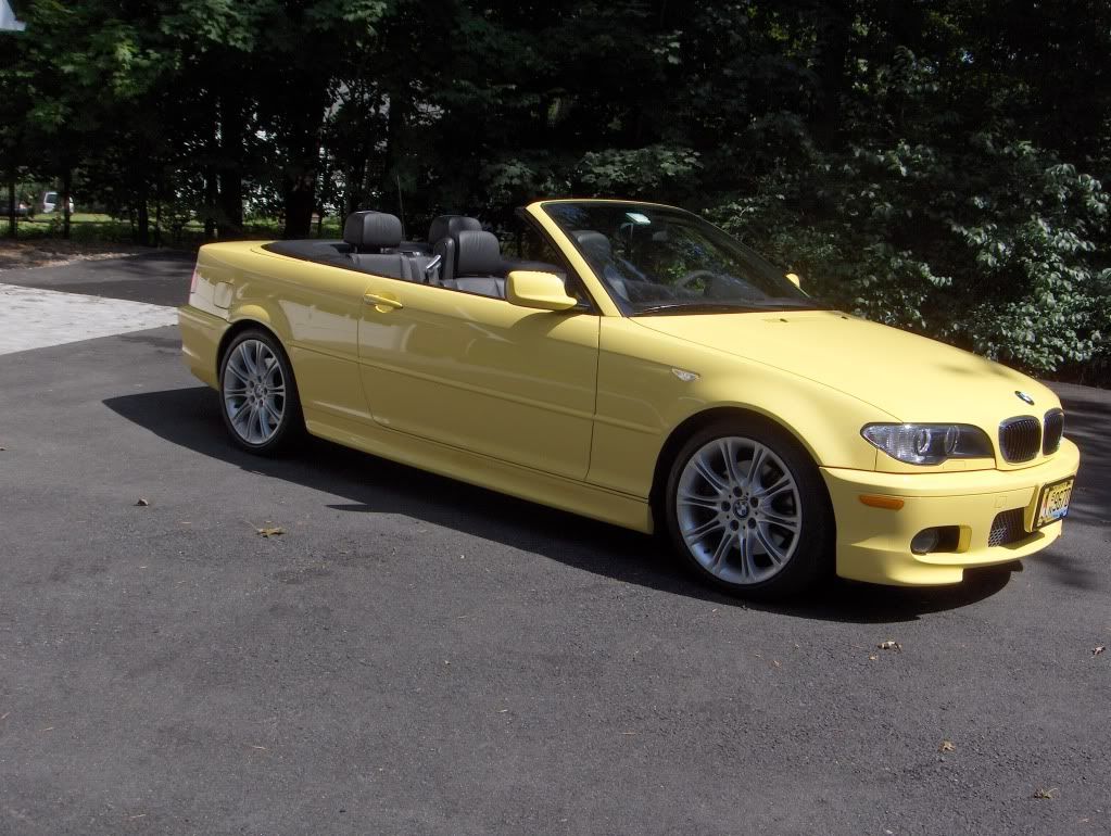

My ZHP is back on the road and the new AFE intake sounds awesome but I've noticed a decrease in fuel economy. Any idea what this is attributable to?
Sent from my Galaxy Nexus using Tapatalk
Damn. That was quick! 328ioc FTW! :)
Trick question. You nailed it the first time. :)
http://img.tapatalk.com/d/14/06/11/jazeny7e.jpg
I fell for it.....
