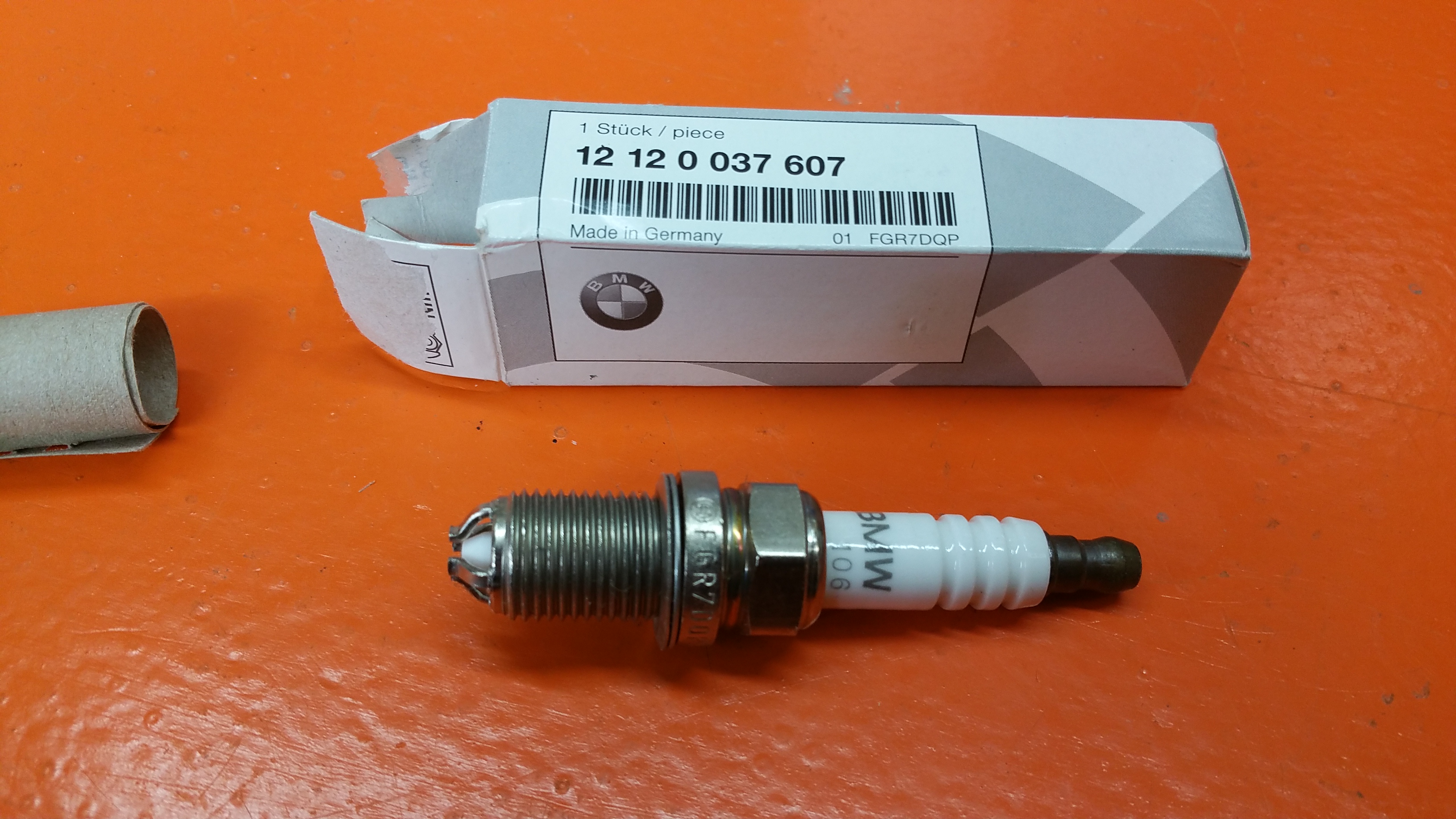

Hey guys, I found some plugs in a box that my brother had and was wondering if anybody has any thoughts on these plugs. I took one of the old ones out and they are a bit different. They do come up as a fit when i searched.
Attachment 34636
Attachment 34637
Thanks
