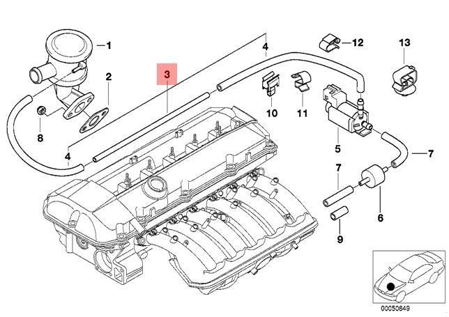

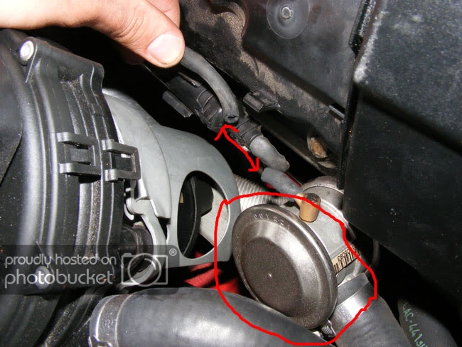

This is not my photo, but the hose runs from the valve along the passenger's side of the valve cover towards the firewall. The ETK makes you believe it's a short length of vacuum hose - not sure how easy to replace - might need a mirror to see it! If the front/visible portion is crumbling I can't imagine what the back section looks like!
Attachment 34674
#4 in the diagram:
Attachment 34676
The zhp doesn't have that vacuum line.
I was going to say, I don't remember seeing that line when I eliminated the SAP and valve
