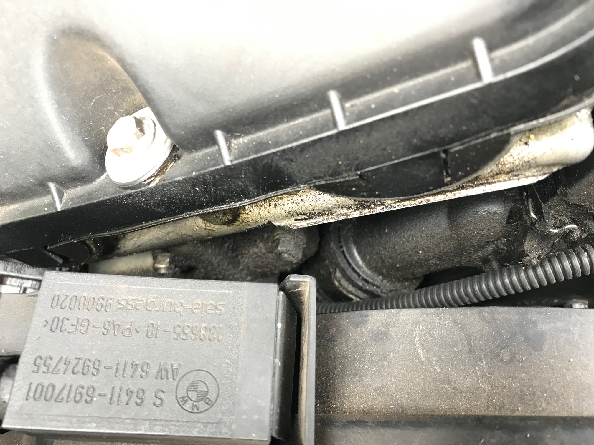

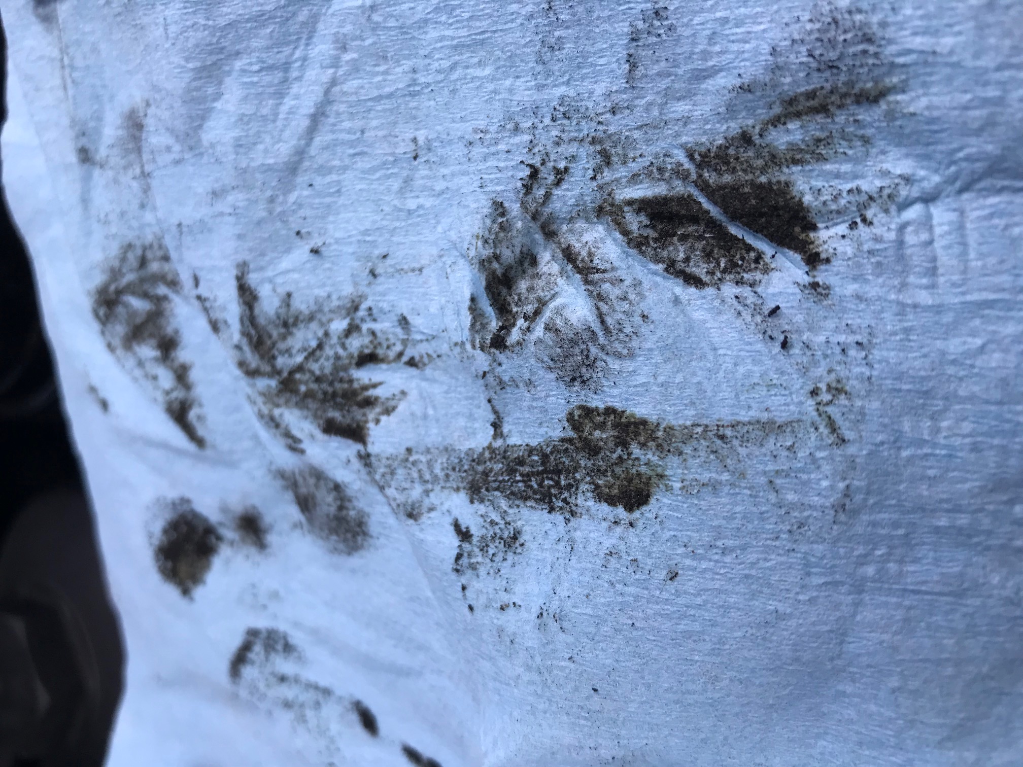

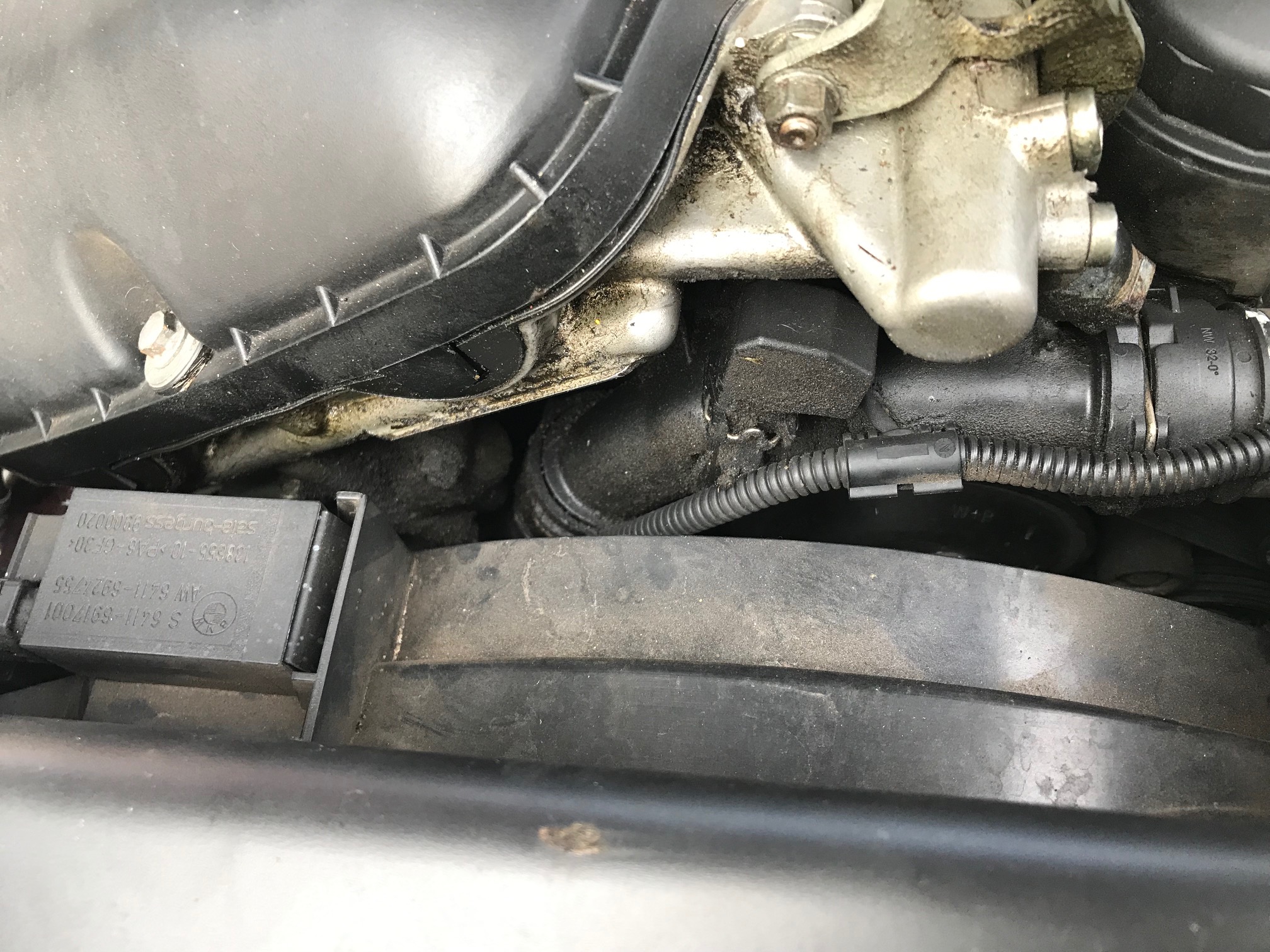

I know these pictures don't tell the whole story, but I've got this residue on the front of the engine as you can see. Is there any chance this could be a slow, long-term coolant leak? I ask because I think I have a slow leak, and I have a water pump and thermostat sitting in my garage waiting for me to install. Or is this more likely VANOS or VCG or something? You can see that it's a dark residue (shown here as wiped off with a blue shop rag). Thanks team.
Attachment 34683
Attachment 34684
Attachment 34685
Check your power steering hoses too. Judging by the residue pattern on your thermostat housing, it looks like it's getting flung up from below.
