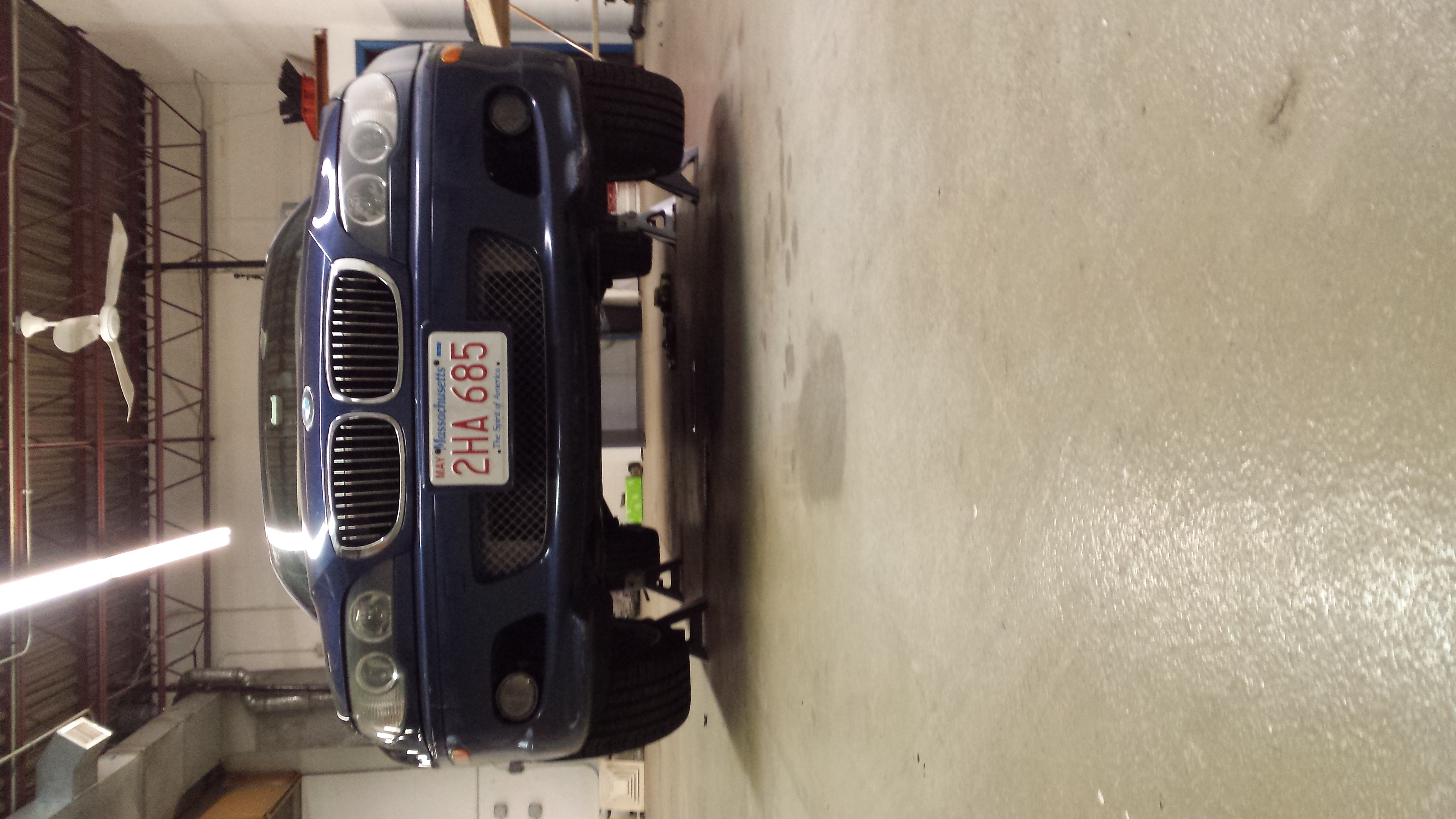

Started the auto to manual swap yesterday on my zhp. So far, took off the exhaust, (only one of the 4 exhaust bolts broke off the stud! Others came off hard after a few minutes of heating them up) also took off the driveshaft, heat shield, splash guard, drained the tranny fluid. Disconnected the shifter linkage. Hopefully today, I'll start pulling out the darn thing! So far so good. I hope the whole project will go as smooth as yesterday. Took me about half a year of researching/hunting for good deals on parts. The 5 speed is a ZF from a Z3.
Attachment 25208
Attachment 25209
Attachment 25210
Nice! Any reason for choosing the 5-speed over a 6-speed equivalent? Definitely document the process with photos!

You are doing a 5 speed swap as well? Noice! Make sure you do the shift pin service on the gearbox for smoother shifting. That will also eliminate the infamous leaning shifter problem.
Mostly pricing. Decent 6-speeds go for around ~$1200. The driveshaft for the 6 speed costs more as well. I picked up a good 5 speed for $455! Plus, with the 6 speed, you need the dual mass flywheel setup, in which that dual mass flywheel alone costs $600. I got a Valeo conversion clutch kit, including the flywheel, for that kind of money. And then theres reliabilty. I've been doing some reading and it seems that people are saying the 5 speed is more reliable.
