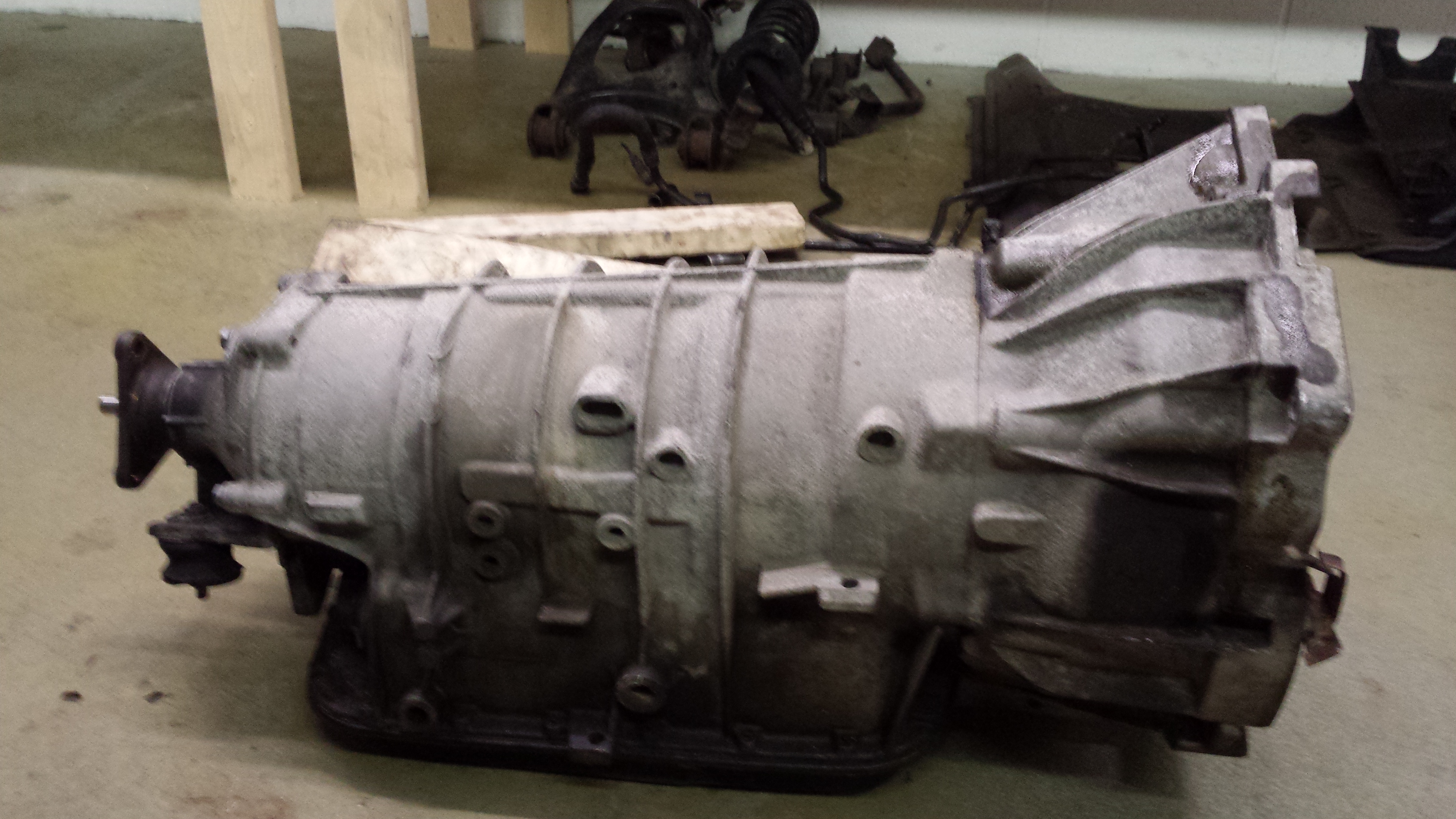

Finally took it out! What a pig! I had to use a ratchet strap and hook it to the rear subframe and pull it out! It just didn't wanna come out at all!!
Attachment 25225

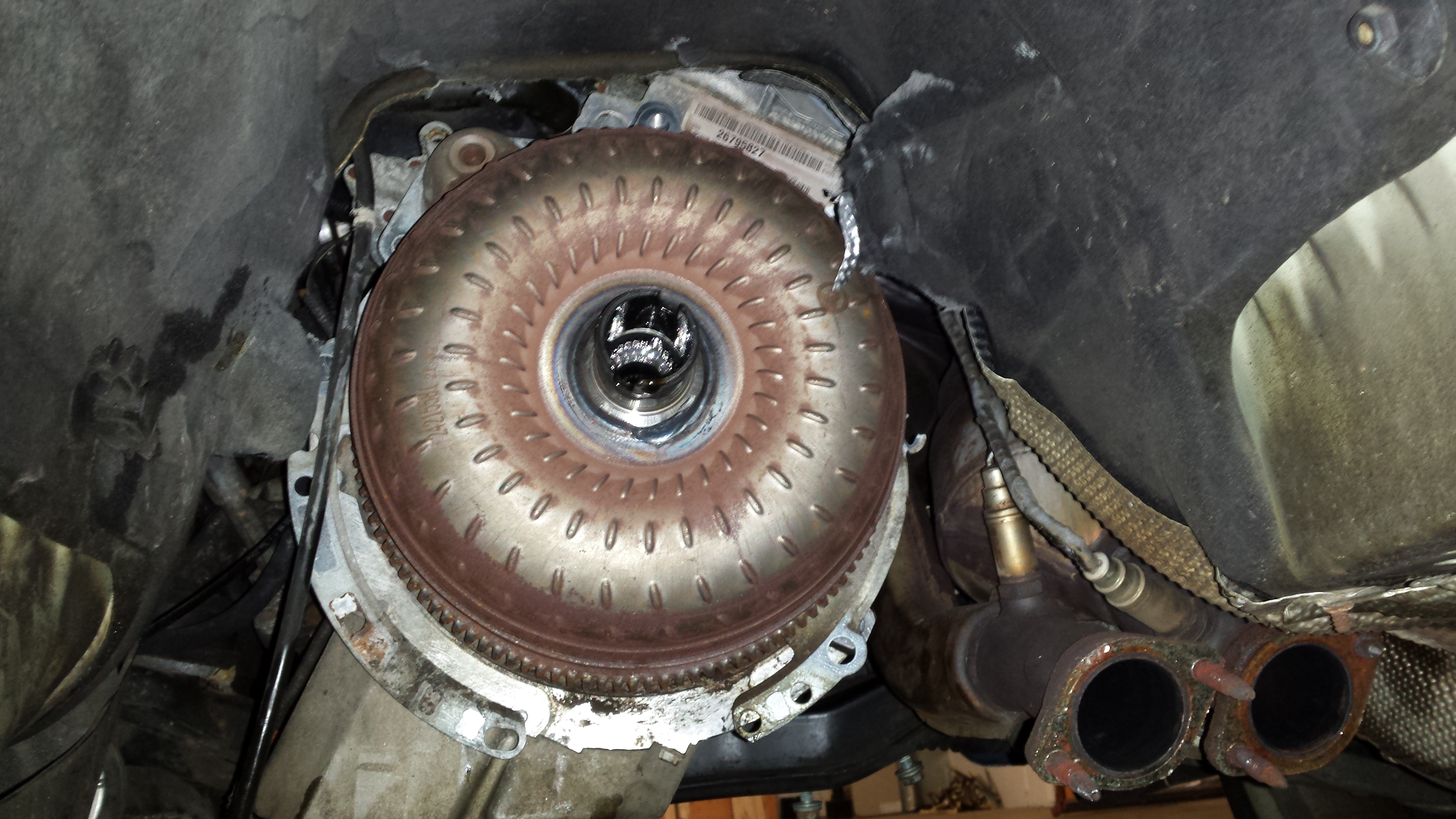

Even though I removed the 3 bolts that hold the torque converter to the flywheel, it still sat in place! I had to remove it seperately. Hence the oil spill! Stupid thing!!
Attachment 25226

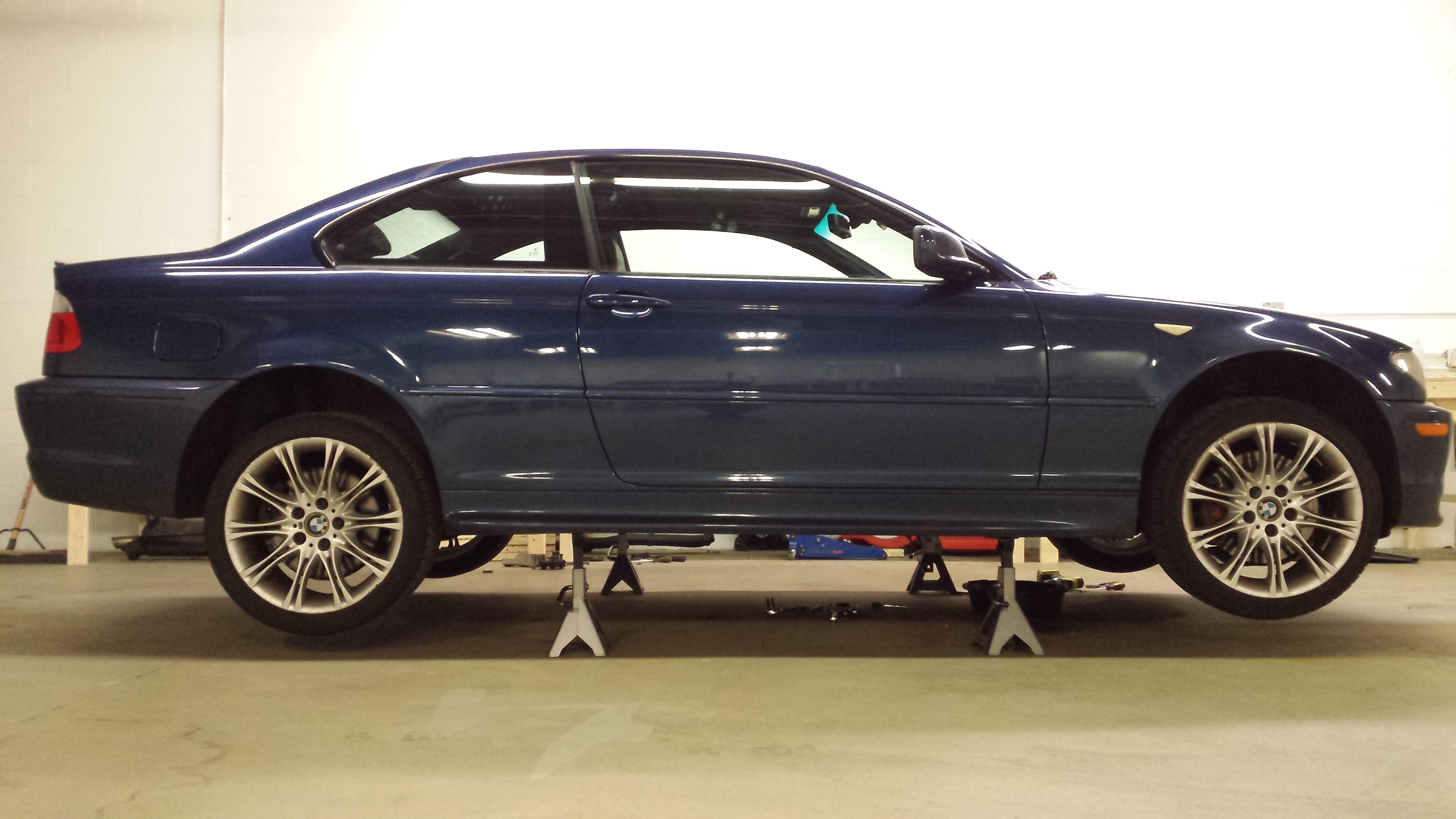

Yes, a tranny swap on jackstands. I do tend to get innovative!
Attachment 25228
