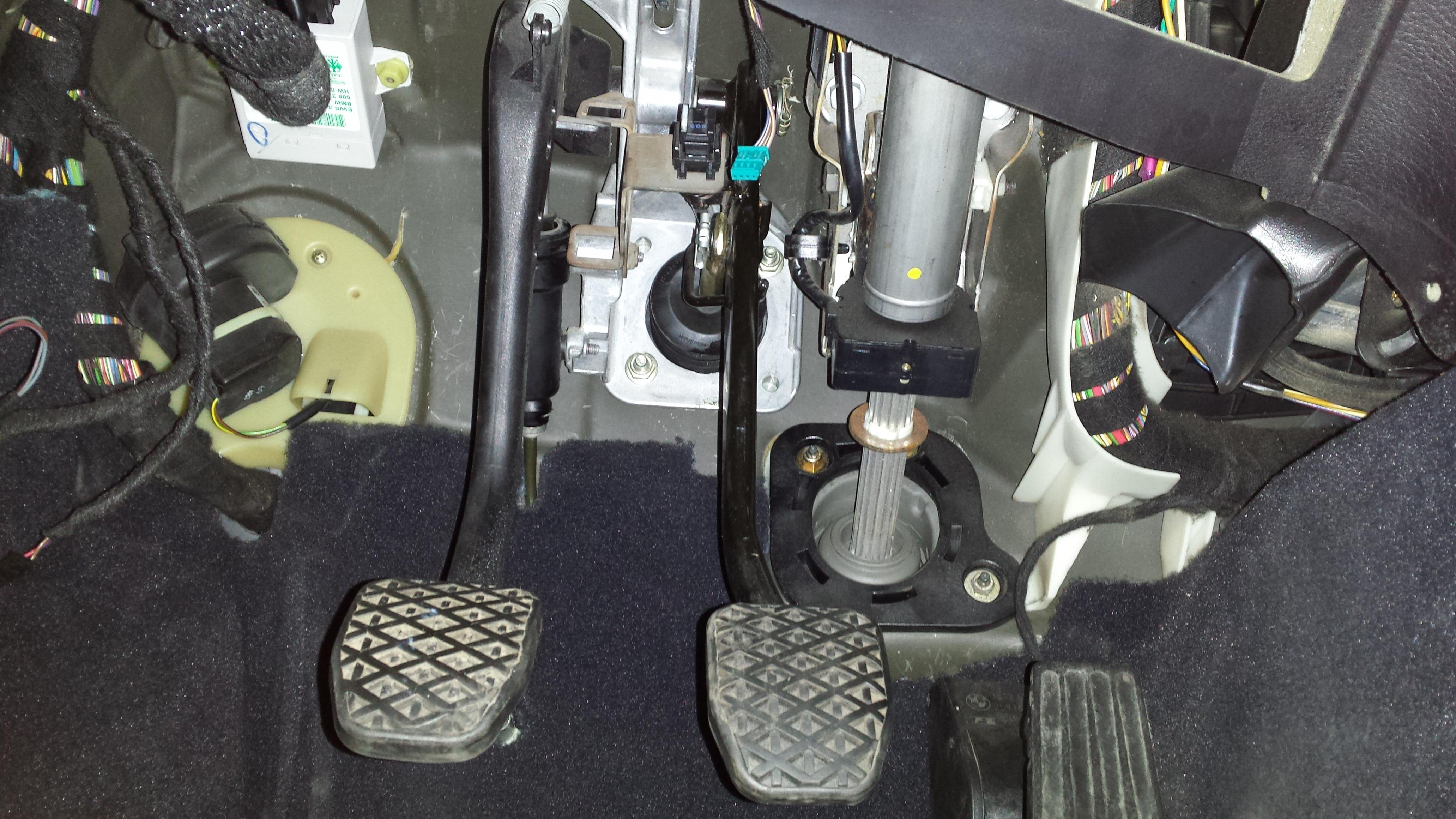

Well, so far the 5 speed swap is going great! Slow progress, but progress nonetheless! Installed the manual pedal assembly.

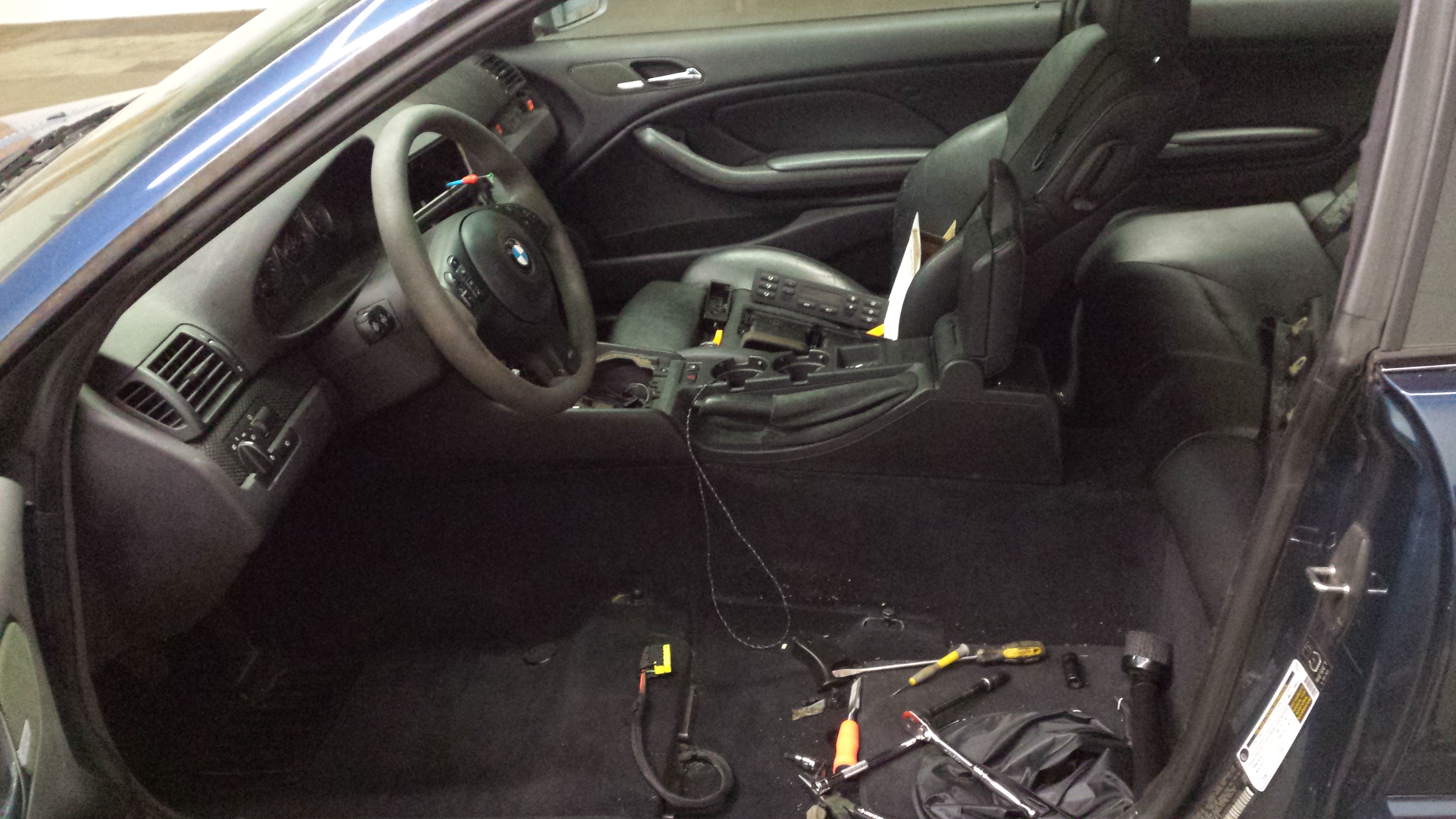

Removing the drivers seat before replacing the pedal assembly makes the job so much easier because you have more room.
