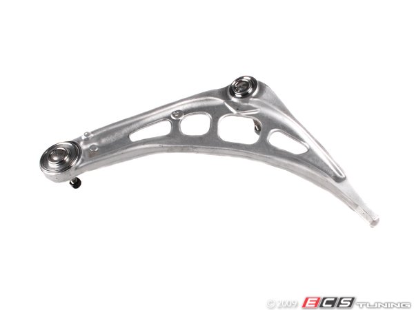

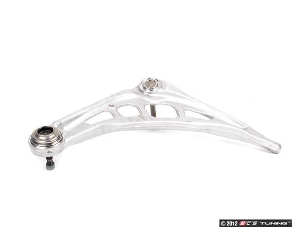

Also an easy way to tell the ZHP and non-ZHP arms apart is to look at the outer ball joint. The bottom of the ZHP arms is much flatter
ZHP:
https://c1552172.ssl.cf0.rackcdn.com/60333_x600.jpg
vs
non-ZHP:
https://c1552172.ssl.cf0.rackcdn.com/279553_x600.jpg
