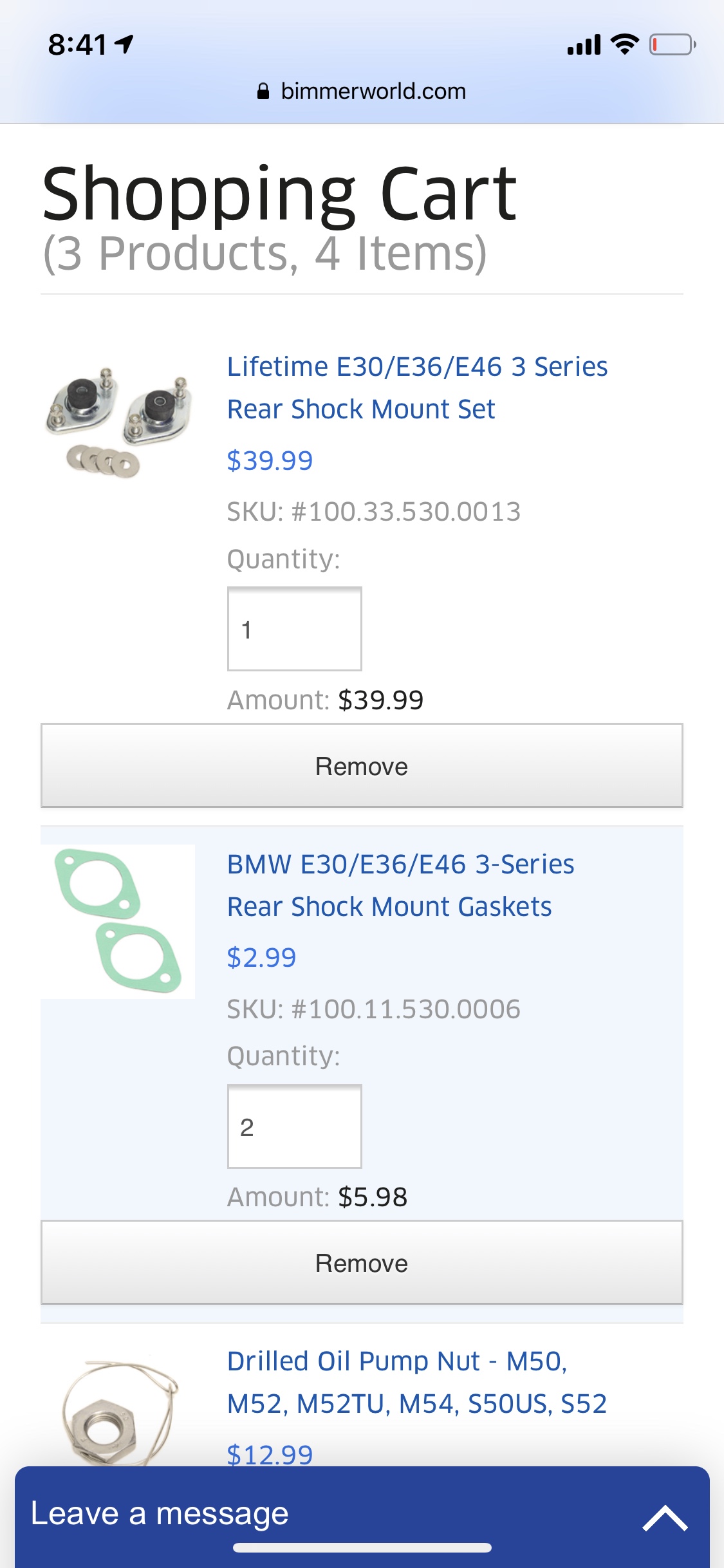

Hey everybody, trying to get back in the swing of things here and I have a question... I’m ordering BC coilovers next week but I wanna get all reinforcements out of the way
So far I have the strut & rear shock plates, still need to order the paper gasket that goes above the RSM’s from the picture above... but if I’m buying new coilovers, Do I need to buy Rear Shock Mounts as well? Hoping to go for Bimmerworlds since there lifetime warrantied and serviceable
Just want to be as preventative and as thorough as possible.

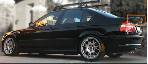

I have another question though. Who's car is this and how can I get that stance. Its perfect! Low but not slammed and fills the wheel wells nicely.
Attachment 35586
I can probably answer that as my stance is practically identical and have the same wheels. [emoji4]
Coilovers will get you the ride height and the BBS CH wheels have an offset that get you that perfect wheel fitment look without the use of spacers.
