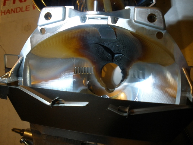

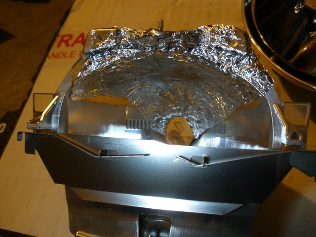

The bowl was burnt worse than I thought from previously just peaking at the back; it has a small crack in center of the most burnt part. Will post pix later. I lined the top 1/3rd of the bowl with aluminum foil and tonight will see if that helps. Then I can put in the new D2S bulbs I got from Khoalty. Thanks to this forum, and some hours of work in the garage, I feel confident enough to retrofit new projector bowls if only some trimming and drilling is required. But hoping the aluminum foil and new bulbs will hold me over until they have a recall on these.

Edit: Adding pics of burnt projector bowl
Attachment 2922Attachment 2924Attachment 2923
