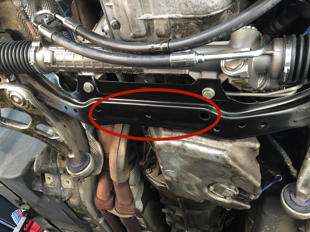

Naturally with all this shut down garbage the zhp sits a lot so i make an effort to drive it for about half hr every weekend, but when i come home and turn it off the oil light goes yellow and stays on for about 10 seconds.
- Checked the oil this Sunday and level seems fine
- Oil change was done Sep 2019 at 62.8k miles, and it’s at 64.6k now. Oil level sender was changed at this visit as well
- OPG was changed Oct 2018 at 57.7k miles
- Engine bay looks clean with no signs of leak

It's a bit difficult to see the oil level from this picture, but the entire rectangular block was wet. Car must not have been leve where it was parked because if you flipped over the stick, the rectangular block was only wet 1/3 of the way up on the other side.

I’m thinking level sensor is failing. The sensor is in the back left part of the pan where the deepest collection area is (see pic), so unless you were parked on an extremely steep nose-down slope I can’t imagine it being steep enough to trigger the light.

FYI the dipstick on these cars is an absolute sack of shit. I was getting the yellow oil light after shutdown with the dipstick looking fat & sassy like yours, so I'm like bruh that oil level sensor is going no doy.
Ordered a new one and went to replace it and only drained like 5qts from the pan
Stupid ass dipstick never even hinted at it being low

The dipstick is pretty accurate. Remember BMW has specific instructions for checking your oil, per your owner's manual.
The engine needs to be warmed up, the car on a perfectly level surface, and checked a few minutes after shutting the engine off.
You'll get a different reading when checking it cold versus engine warmed up a few minutes after shutting off.
