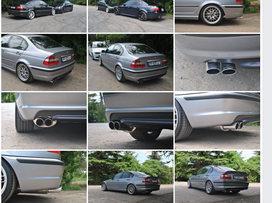

Today i installed the supersprint muffler, it is a fine piece of art :D The sound for me is pretty much the same as the ZHP but friends tell me it is more aggresive :D IDK. Check out my flickr account for pictures.
Flickr @ https://www.flickr.com/photos/187906...h/49901364873/
Attachment 36578
