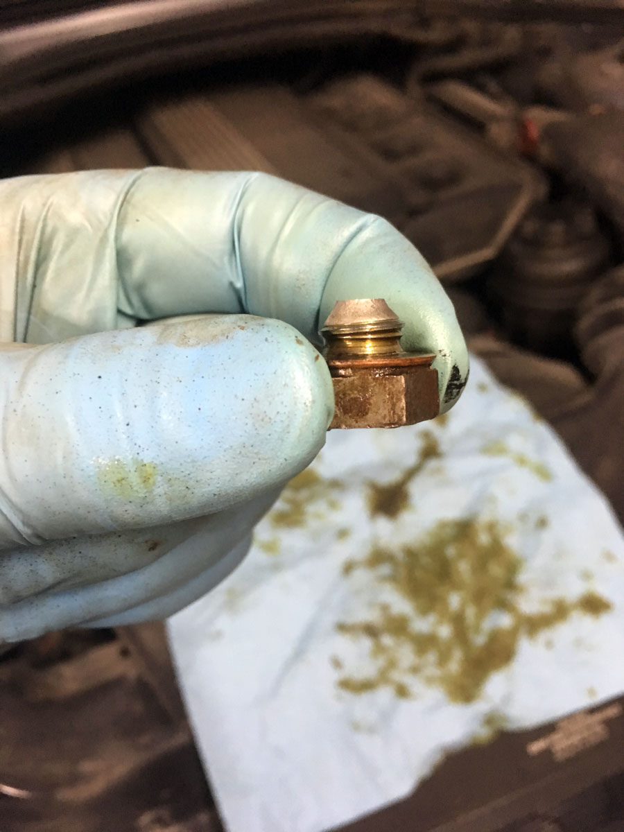

so i get to work - the oil pan drain bolt had almost zero resistance, and he is what i found when i removed it... well, whatever 'it' is. i'm really surprising it wasn't leaking, because this thing was barely making any kind of a seal at all.
this is why you should change you own oil. i'm assuming the oil change place they brought it to before put this into the oil pan... cause it sure ain't stock:
Attachment 29716
i spent about 45 minutes looking through fastener bins trying to find something suitable that i could use for an oil pan bolt - it's an M12 x 1.5, which is not really used anywhere on the car except for wheel lug bolts. and that wouldn't work. finally i found one that was the correct thread pitch, but was a bit long - so i stacked 6 thick washers under the head, and then a fresh crush washer, and in it went. i was relieved when it was in and tightened.

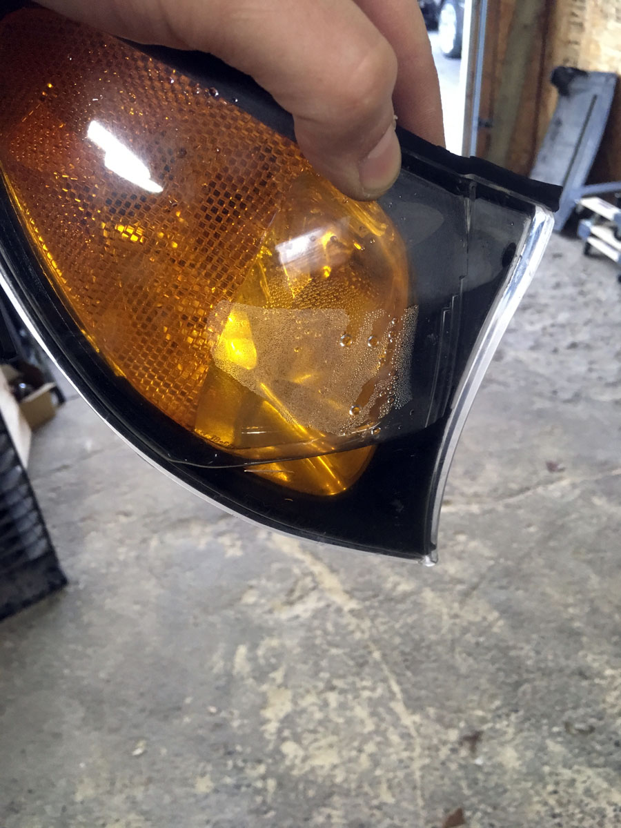

i also found the right front corner light had a lot of condensation in it.... i had a spare so i replaced it, and when i took the old one out (TYC brand - cheap aftermarket crap), look at how much water it had taken on!
Attachment 29717
