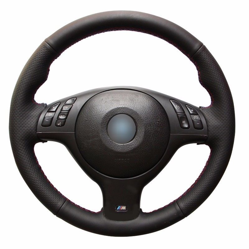

I also ordered a leather steering wheel cover from China for $43. My Alcantara wheel is pretty damaged in two spots and I can't justify $300+ or more for a quality refinished one. Instructions say that it goes over the original leather so I'll have to find some foam/padding to the low spots.
http://www.ebay.com/itm/112365331223
Attachment 30144
https://i.imgur.com/dDNZuEB.jpg?2
The part covered in paracord is worse. Most likely rubbing from the previous owner getting and out of the car.
https://i.imgur.com/XH79qtc.jpg
I would NOT install that cover over anything you already have installed. I'd remove the material that's on there, THEN wrap it.
Why is that?
I'm guessing they recommend to do that way because the wrap is already cut and stitched for a certain diameter. Removing any material will make it a loose(r) fit. On the other hand, the Alcantara material on there looks pretty thin so there's no loss/gain in removing it beforehand.
Because if you don't remove the material, you will get a lumpy/uneven wrap. The material underneath wouldn't be consistent, so neither would the covering material. Removing the worn alcantara layer will provide you a smooth, even surface to apply the wrap to.
