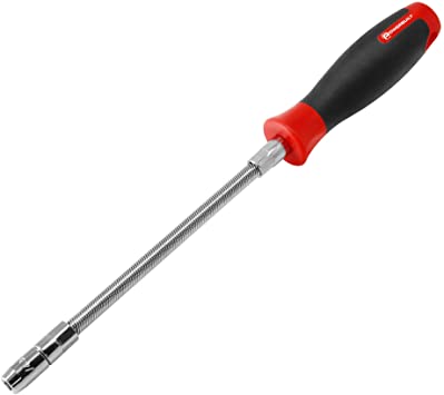

Does anyone have any recommendations as to how to access this hose clamp if the bolt is facing the other way (i.e. downwards)? It is on the lower intake boot, but the upper hose portion of that boot, specifically the portion going to the ICV.
EDIT: Nevermind, I got it.
https://i.imgur.com/ee84Va3.png
Yeah it’s important to orient that bolt such that it can be easily reached the next time someone goes in there

I believe the boots are put in as a combo or in from the bottom originally, with no regards to being replaced. That's where a flexible hose clamp driver can help, or go blindly in with a socket & ratchet!
Attachment 38637
Since I do not have a flexible hose clamp driver, this was me last night:
https://i.imgur.com/bDMwm4U.gif
