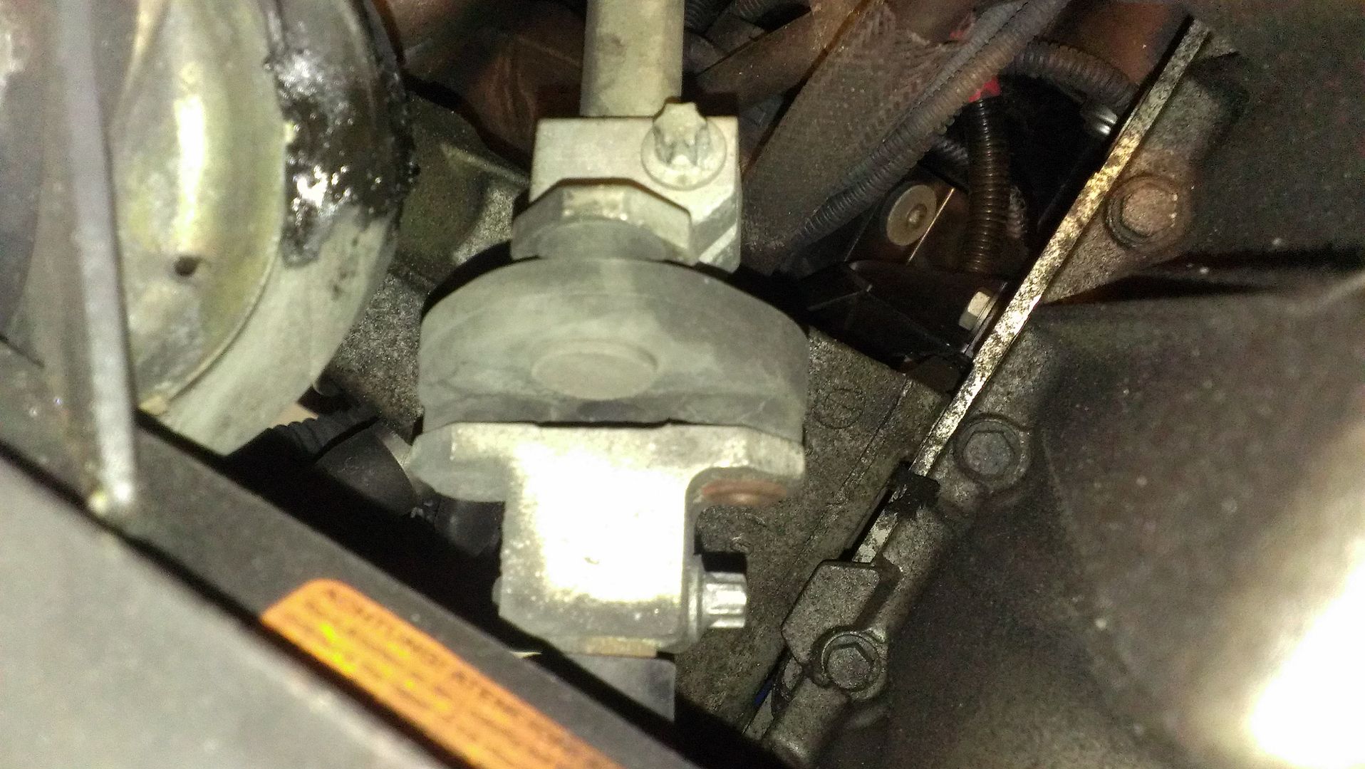

Guibo done.

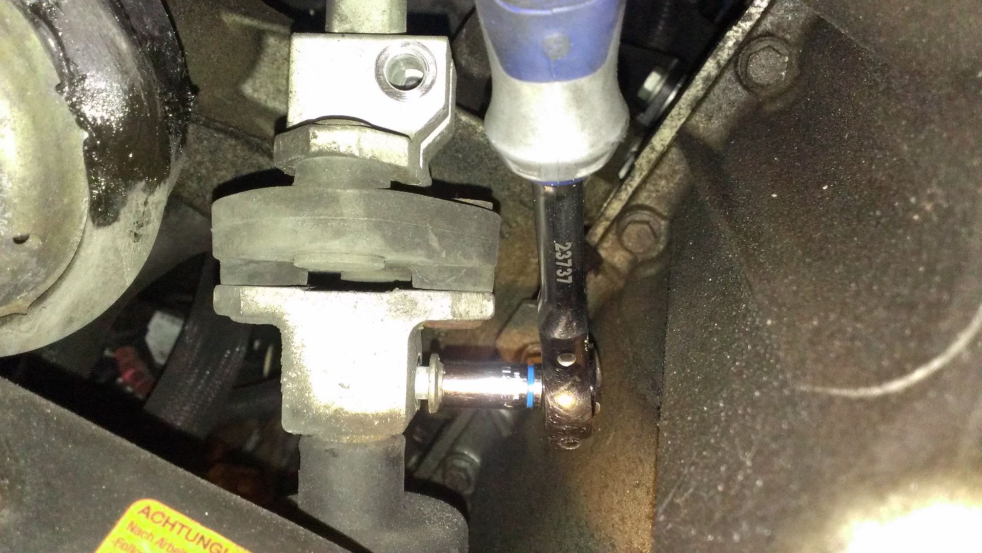

Used an 8mm here.
http://i1015.photobucket.com/albums/...c/IMAG0470.jpg

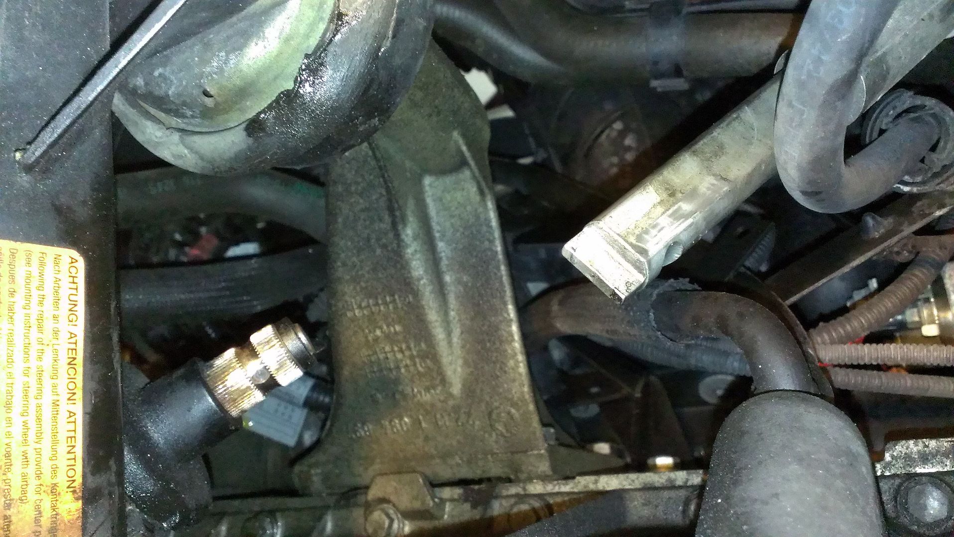

Removed
http://i1015.photobucket.com/albums/...c/IMAG0473.jpg

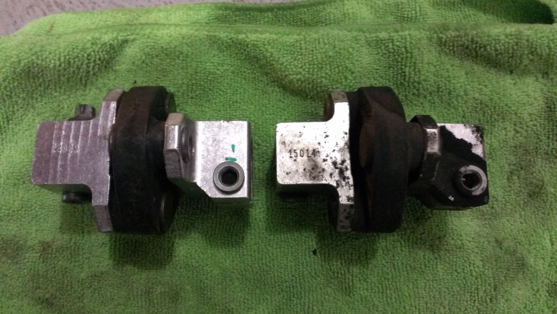

Comparison
http://i1015.photobucket.com/albums/...4e03f6f529.jpg
And...
http://i1015.photobucket.com/albums/...c/IMAG0479.jpg

Dane, I bet your steering will be much improved after doing that! :thumbsup That's something I need to look at doing myself...
Mine came in Monday! Was it as easy to replace as your pics make it look?

I keed .... My steering just didn't feel as responsive as it had in years past.
Let's hope so.
It was pretty easy. I put the car on ramps. Removed splash guard and center reinforcement plate. I used an 8mm socket on lower bolt and a torx socket on upper bolt. Upper portion is telescoping, so from here is a muscle game to walk the gumbo up the upper shift and remove being careful not to ding the dental teeth.
I put some blue thread lock on each bolt and reinstalled. Took about an hour.
