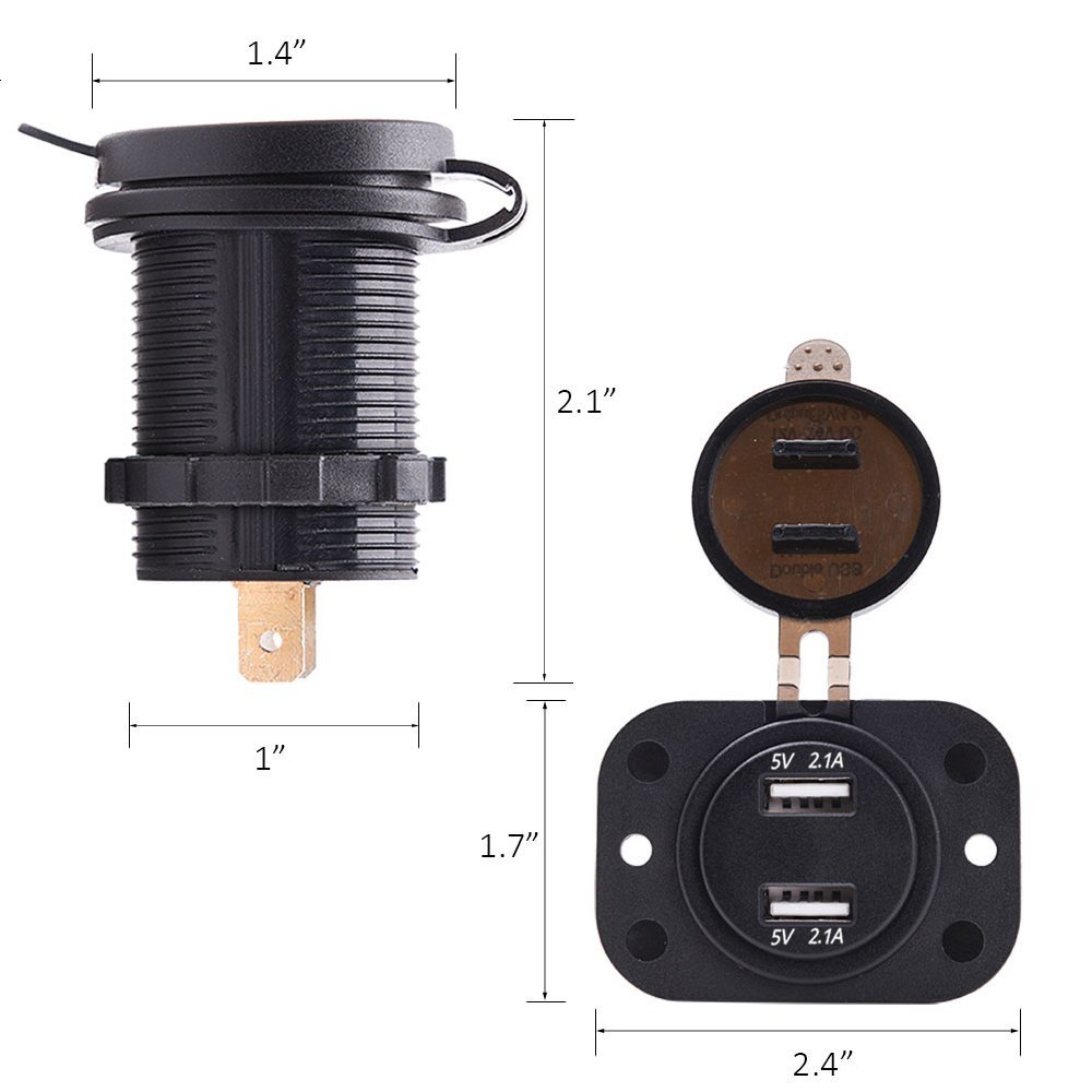

Well, like all cars in my stable, the Martlet is getting a few small upgrades here and there.

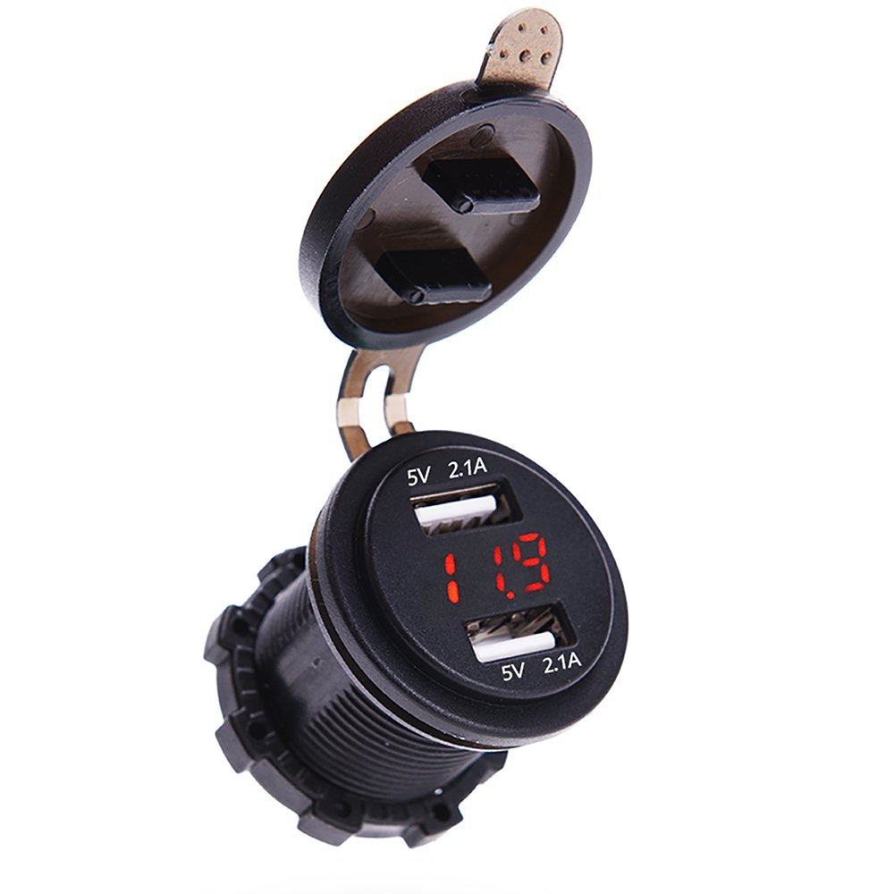

I wanted a sleek way to charge my phones without disturbing the dynamic of the dashboard.
The cigarette lighter was broken, so I decided to peruse the interweb and find something that wouldn't look too tacky or tacked on.
I found this: https://www.amazon.com/gp/product/B0...?ie=UTF8&psc=1
Attachment 30906
I liked the idea of getting a decent charge for my devices, ability to use my (useless) cigarette lighter, and the fact that I could cover it when I was not using it with a stock plastic cover. The dimensions fit the stock cigarette lighter profile and required very little modification with a rotary tool.

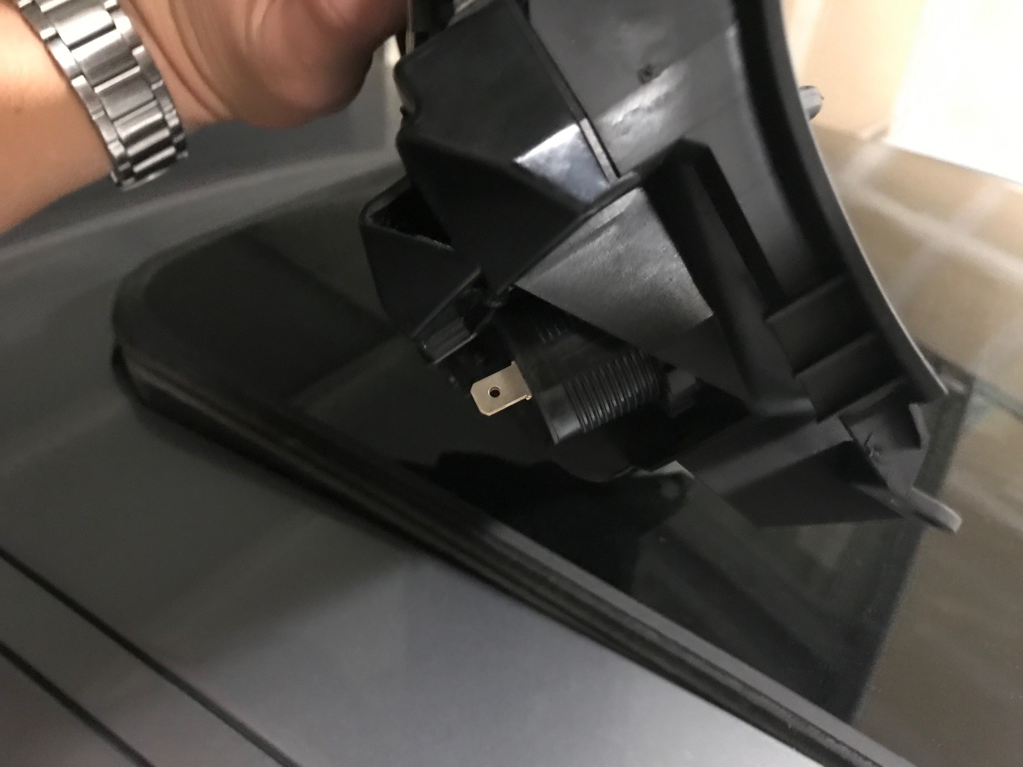

Attachment 30907
Let your imagination fill in the gaps of the process.

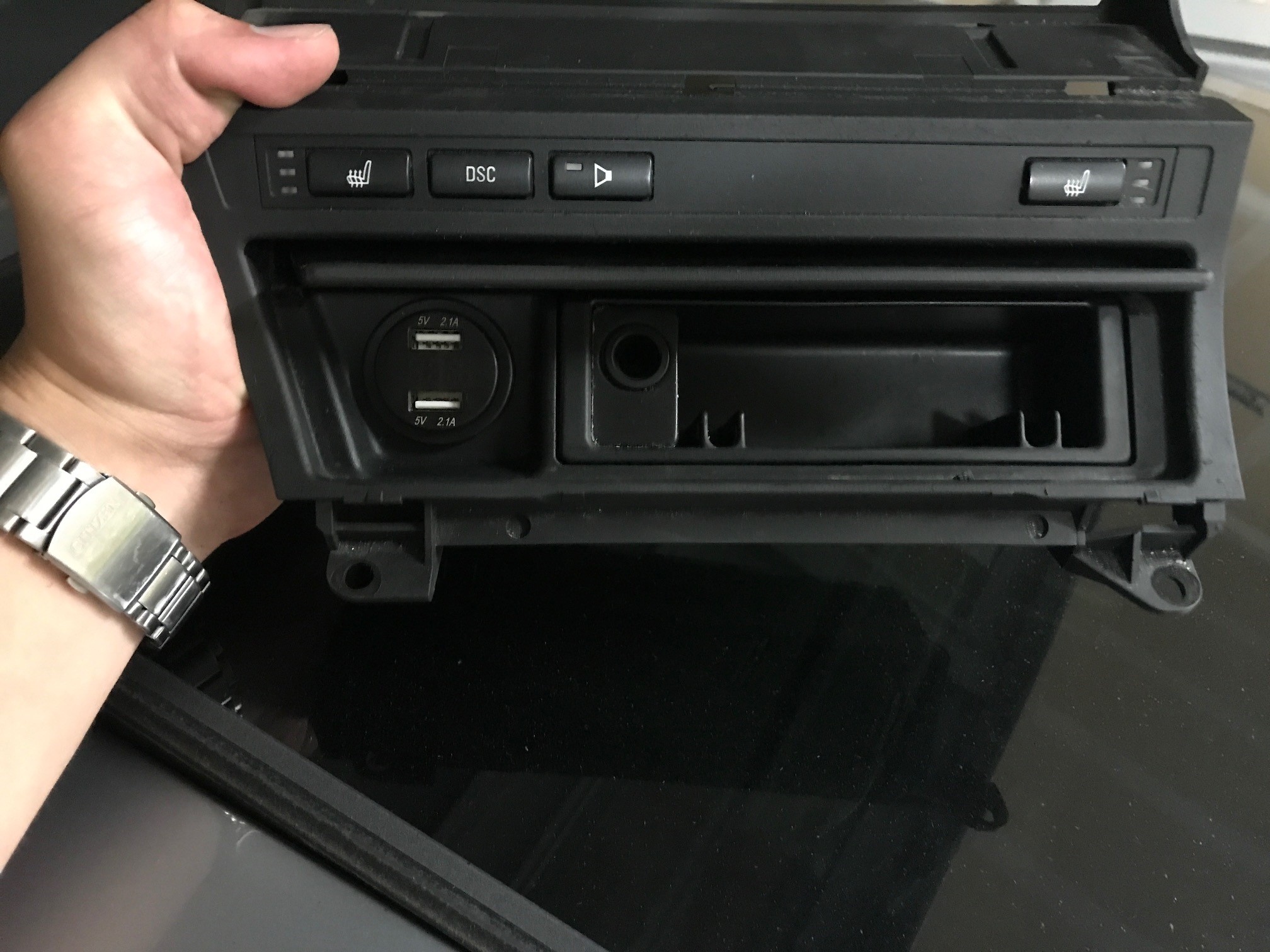

Attachment 30908
Attachment 30909
Once you remove the panel, you will see two wires, a brown wire with your un-shielded connector and a red and yellow wire that has the constant hot.
Please disconnect your battery when doing this, knowing that some of you may not, consider the fact that it its the amperage that kills you, not the voltage. That being said, this probably won't kill you, but it will give you a dead arm.

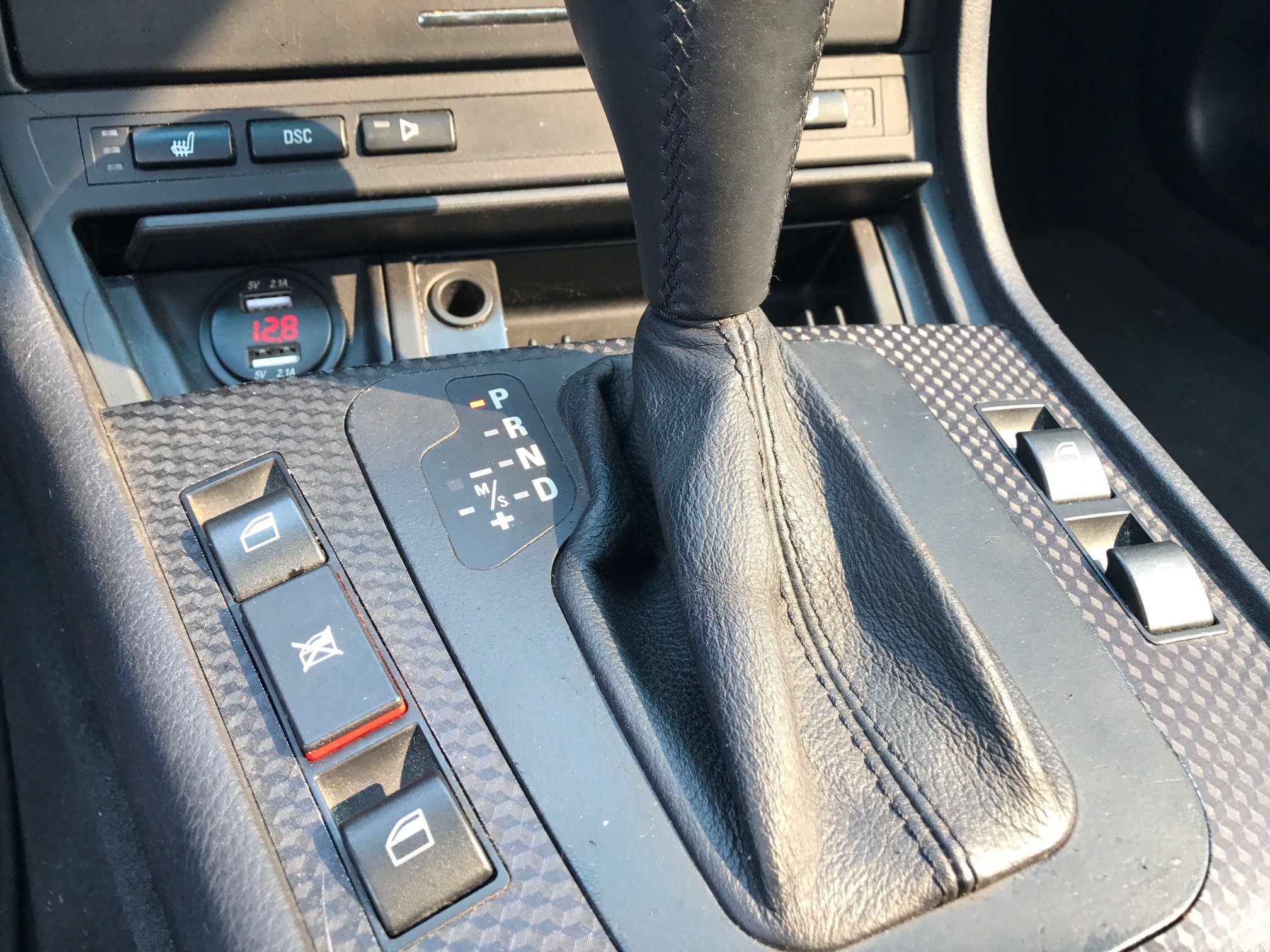

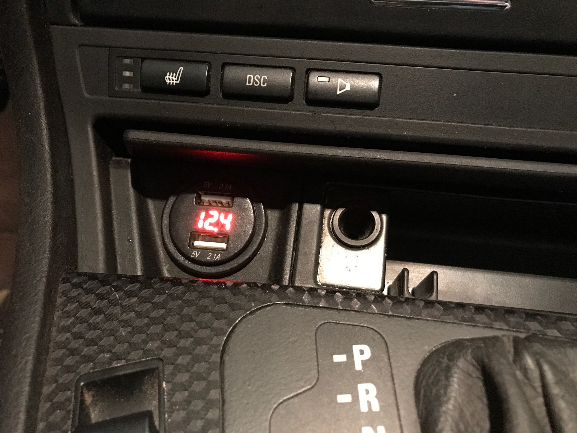

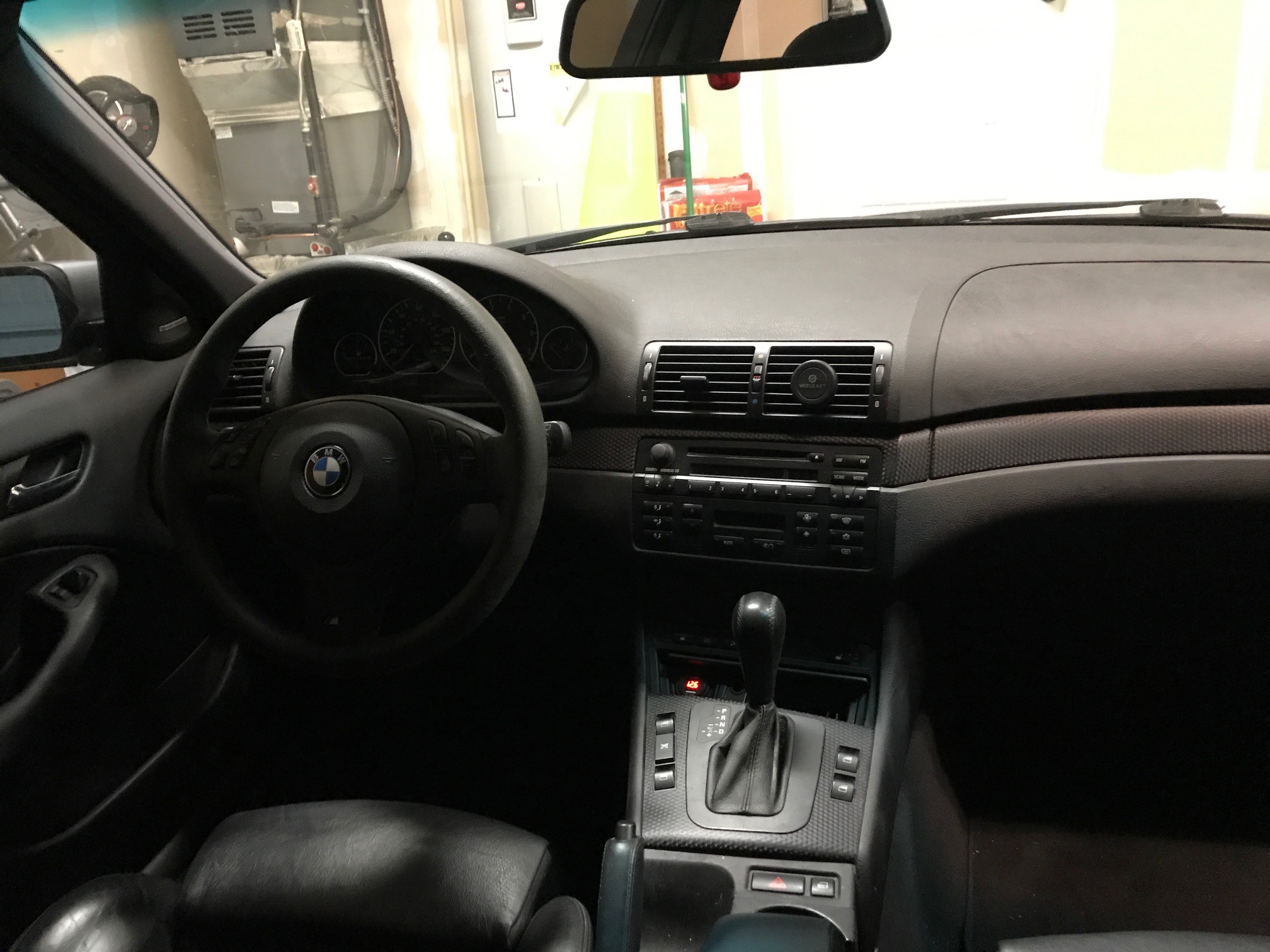

Here is how it looks in the car:
Attachment 30910
Attachment 30911
Attachment 30912
I hope someone will find this :ninja (ninja) power and battery status readout install useful.
One thing to know is that this set up will *eventually* kill the battery. Seeing as how the meter is constantly on. I may try to sneak a little toggle switch in the ashtray next to the Volt Meter to remediate that fault later.

that USB thing is cool.... i might need to get one of those!
